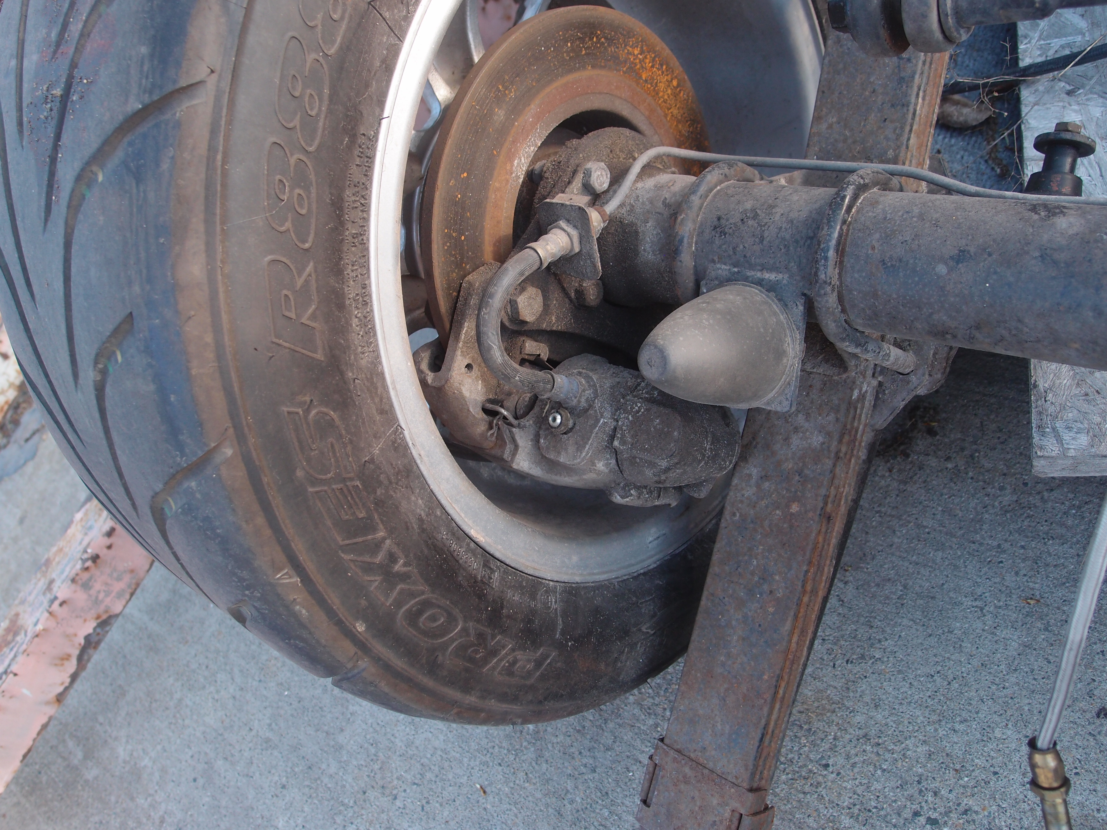

Is the pictured set-up below the Fiat (X 1/9??) installation that I have heard of? It has unequal length cables for the e-brake sections of the calipers. This is installed behind a 14" wheel. It doesn't appear that a 13" wheel will fit over the caliper body.

There is also an offset rebound rubber about 2-3" aft of the front spring eye... These were introduced about mid way through the MK1a.
Do you recognize what the brakes are from??

No idea, but those have to be the smallest discs I have seen :)

That looks like the Fiat X1/9-124 rear caliper.
Different rotors were used through the years with different offsets.
With the right combination, 13" wheels could be used.

confirms what I thought. Thanks! Not sure these would be much of an improvement over the drums. Not much surface area for the brake pads.

The good news about the Fiat calipers was they were a good choice for good brake balance.
Also there are better friction materials available for them.
However, the pads are VERY thin.

I have this setup on my IA . And can't fit 13s on the back
It sure didn't look to me like a 13" wheel would fit, the ones in the pic are 14" Panasports... it'd be a drag to get a flat, my spare is a 13"!

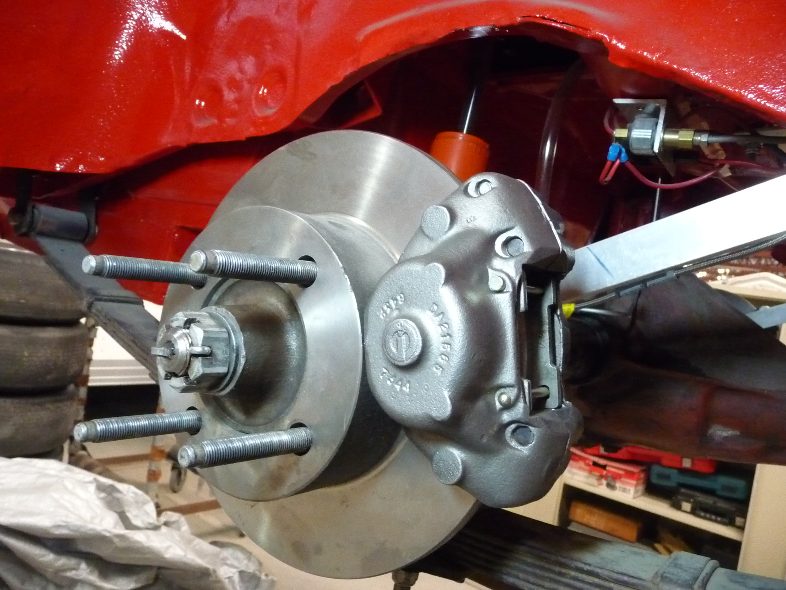

The Go-to Rear brake rotor to use with 13" wheels is this:
The rotor needs to be machined for the center hole but has the correct hole pattern.
The app is an 1984 Audi 5000 S Turbo

The caliper is a early Volvo 1800. no provision for a parking brake.
Also a good choice for decent front/rear balance.
And a decent pad availablity and thickness.

Interesting... I am guessing that you fabricated the caliper mounting brackets? This would work for a track car, but, personally I'd like to have an e-brake!
