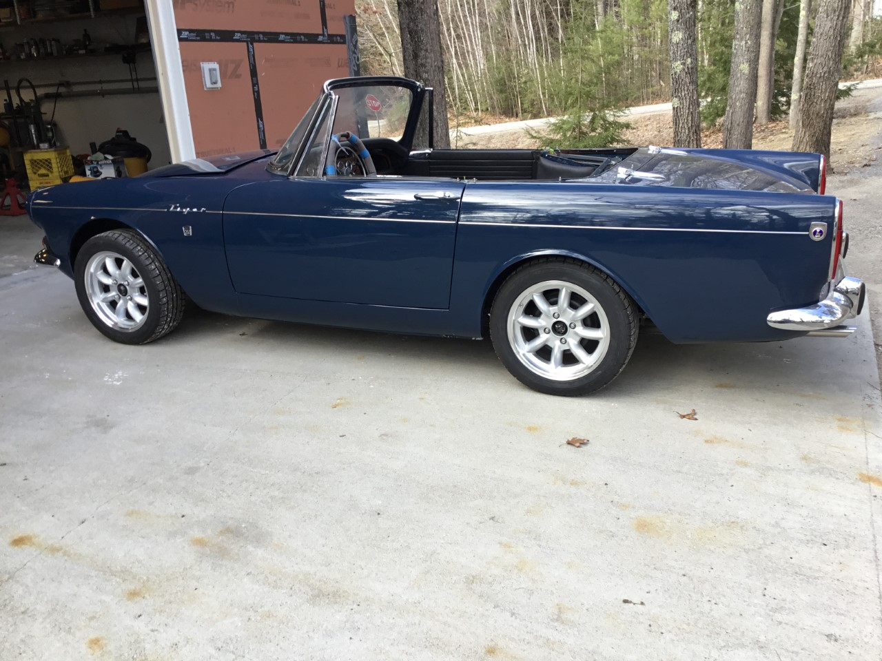

I used less expensive ROTA instead of Panasports. Like these except offsets 20. Probably could go offset 25 and used 185/55 and 195/55
https://www.ebay.com/itm/2942579799...1291&msclkid=0467b5336ef91b7f86ebd72655cc3508

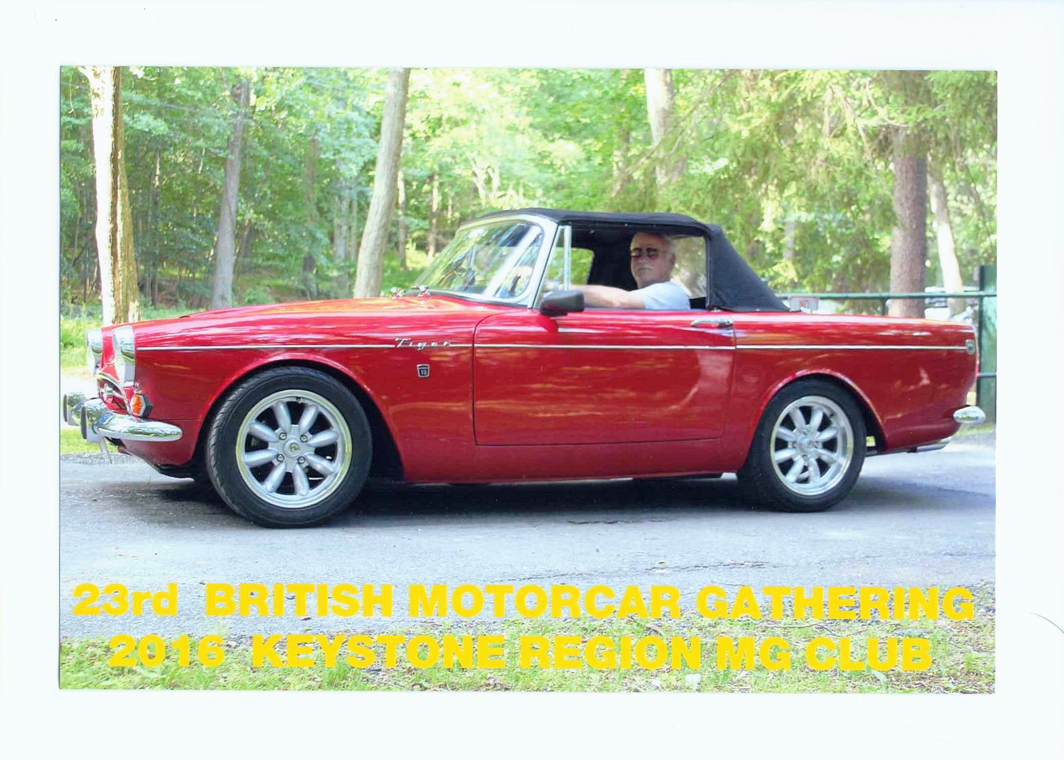

1,419
Running 195's in the front and 205's in the rear on Minilites. 205 is the max width that will fit.. Running narrower in the front so the steering isn't heavier than it needs to be!
4,175
What profile is important as that will determine if the front rolling radius is a little large and takes nibble out of the front valance.
Are the front 195/55/15 or 195/50/15?
Regars assume 205/50/15?
