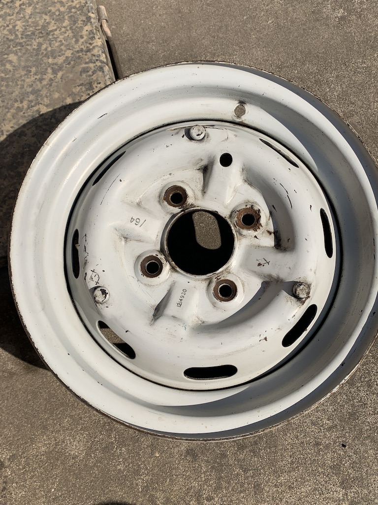

I will post a picture of one of my original painted wheels with a piece of white paper soon. The color samples look very gray to me
IvaTiger
569
these photos are of the inside of the spare wheel ( tire removed ) the paint is glossy and represents the true color because the tire was removed a few months ago so no fading or weathering. It was taken in very bright sunlight alongside the latest Tiger Tales to represent the shade of white.
