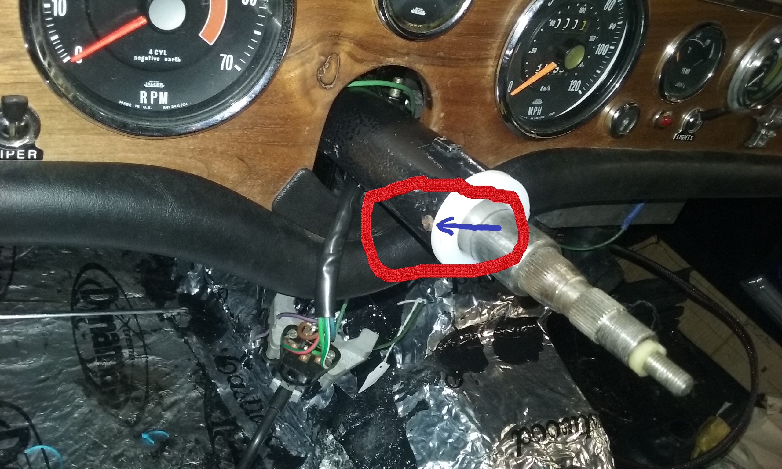

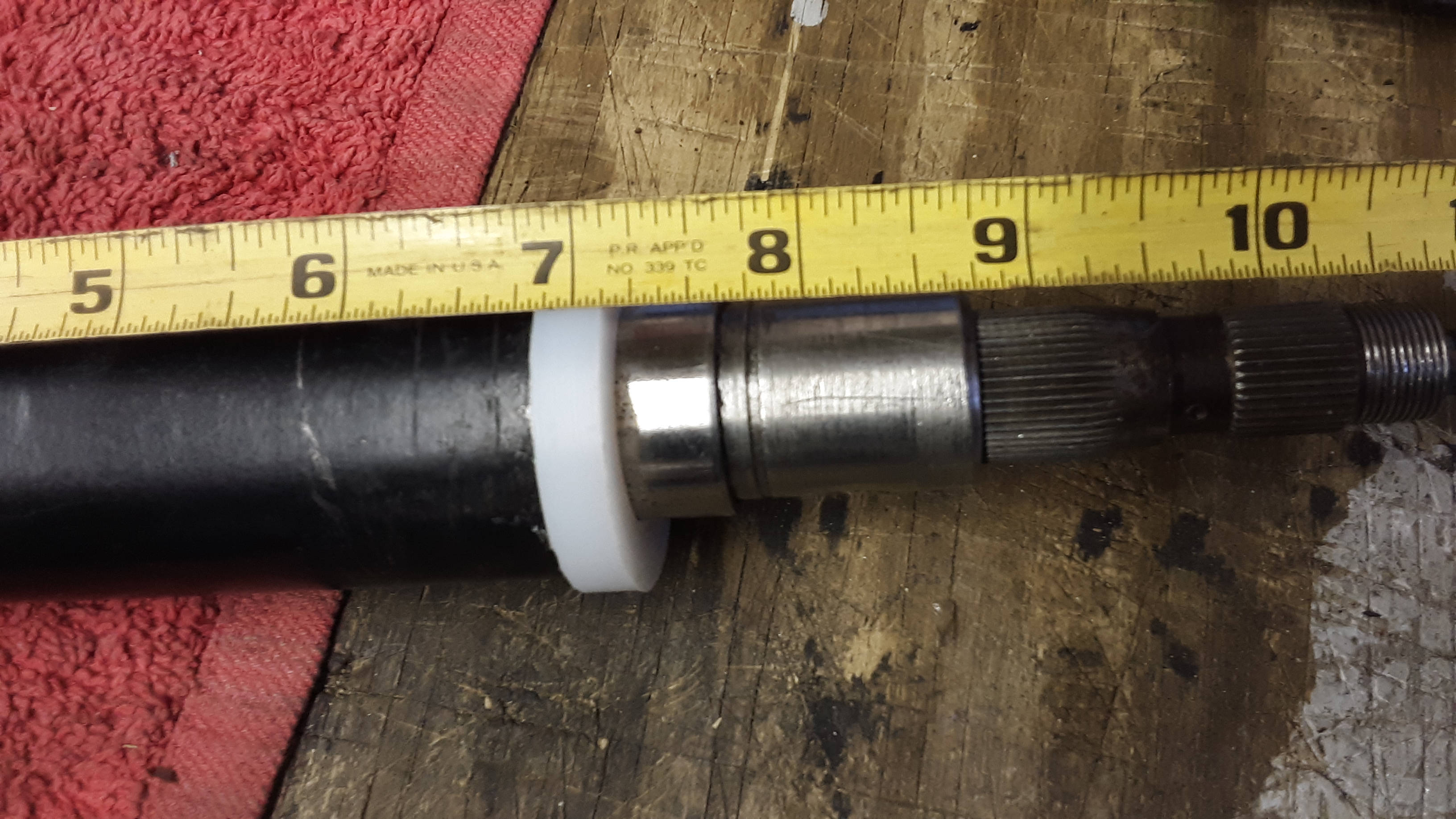

Upper Steering Bushing
Not original solution, But I had some bushings made for my Alpine V6 steering column.
They are a very hard plastic and durable. Utilized for my EPS steering because I could not get replacement for the stock bearing race that had worn badly.
  • EPS new bushing mounted.  Screw indicates a fix for the bearing retention 20180217_190036.jpg
