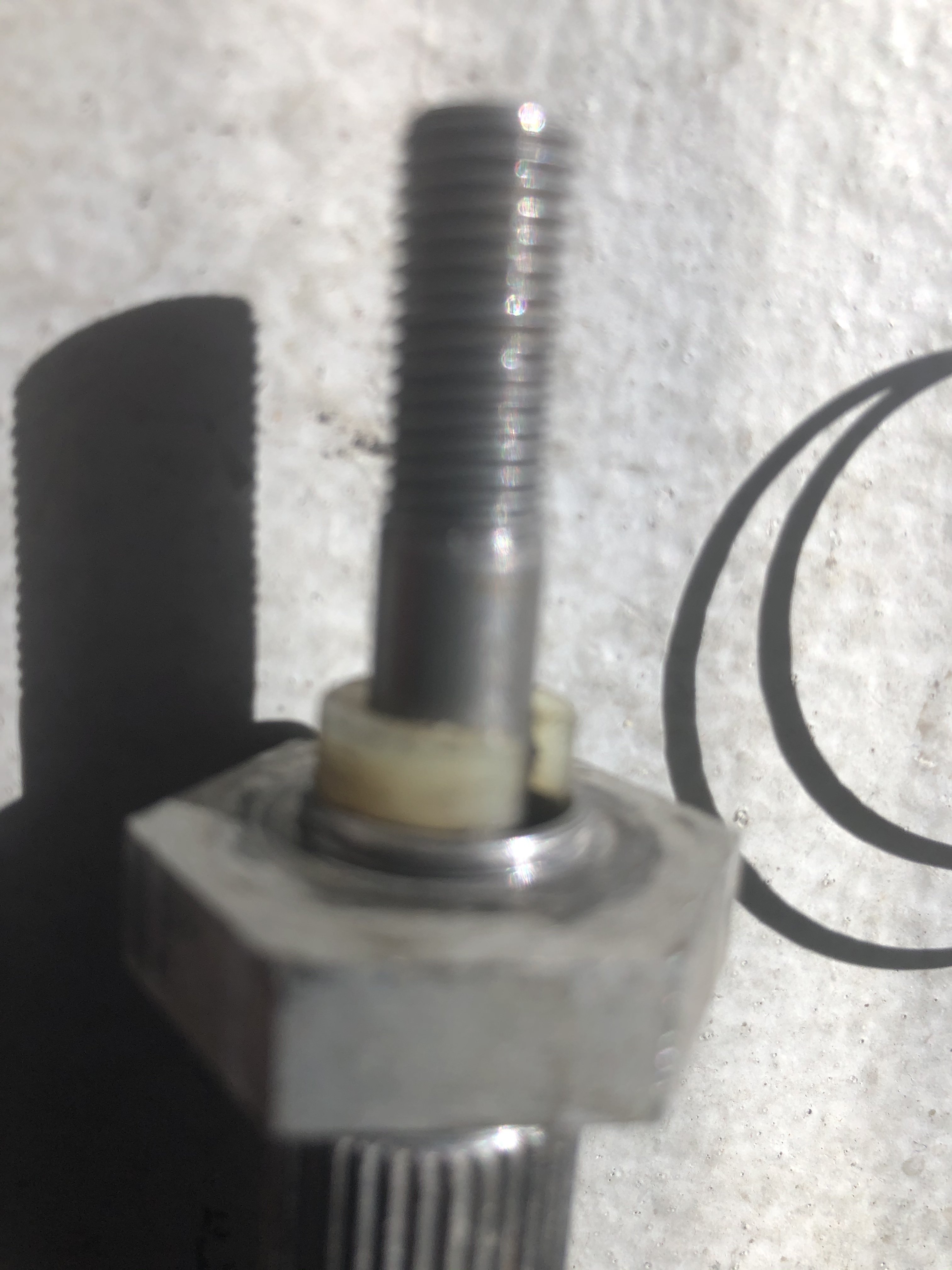

I am rebuilding my steering column and there does not seem to be a rubber bung in the shaft to keep the expanding adjuster from falling into the shaft. Does anyone know what this bung is or looks like. Could I use a rubber stopper?
IvaTiger
569
I've used a cut piece of plastic from. Funny I have the plastic piece sitting on the table now.
1,245

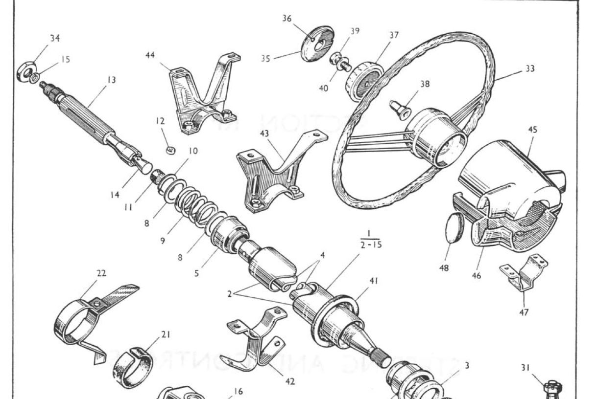

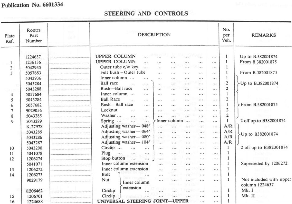

The manual shows and calls out a rubber bung.
The Rootes Parts Manual Supplement for the Tiger does not list any rubber bung for keeping the inner column extension shaft (the adjuster) from sliding down the column. The photo Tony Butler posted matches what my Tiger had when I got it in 1970. It is the nylon clip which prevents that shaft from going down inside the upper column. I could be wrong, but believe part number 15 on the diagram is that nylon clip.

I have the manual in pdf from and am trying to attach. I hope it is readable. Anyway, I think what I am talking about is #11, the plug or in the manual, #5, it is called the rubber bung.
The rubber bung acts as a cushion when the steering shaft is retracted fully so it does not slam metal to metal and would give some kind of protection to the driver in case of an accident It does not stop the shaft from dropping down the steering tube, the plastic c clip does that
5 is the rubber bung and 11 is the plastic c clip
IvaTiger
569
The whole shaft would drop into the steering tube ,without the plastic c clip on the shaft part number 3
I've taken a couple off original car's so I'd have to agree with Tony and Dave.
I used a plastic circle cut out of a cool whip plastic lid. As for the Bung haven't gotten down that :)
