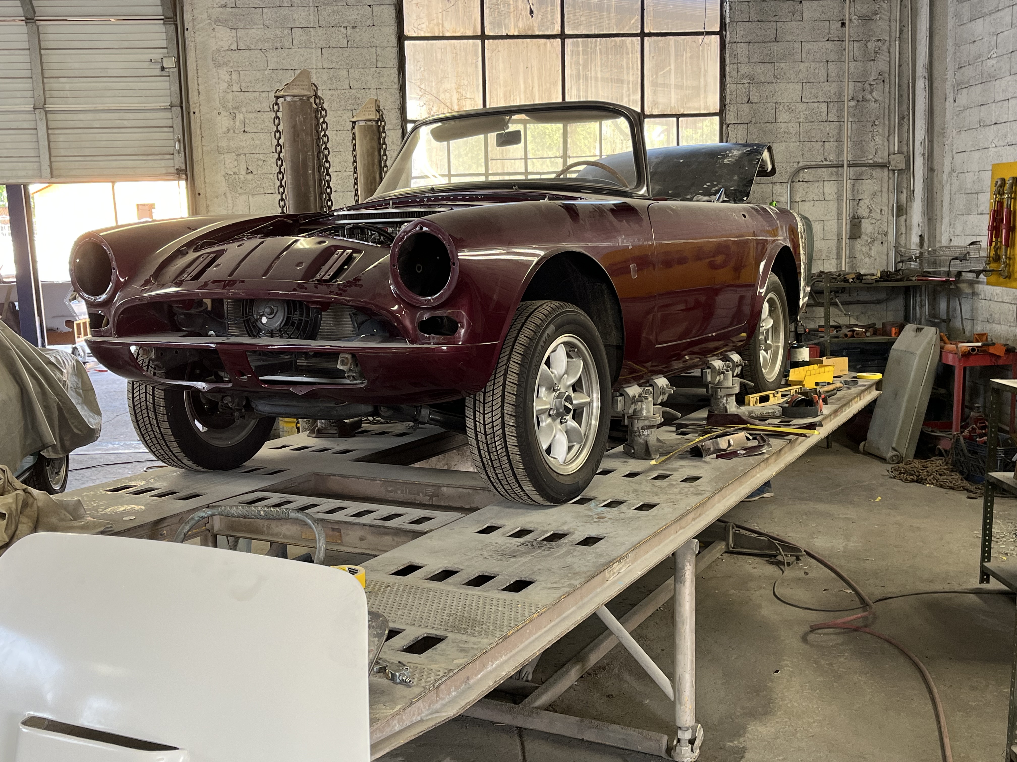

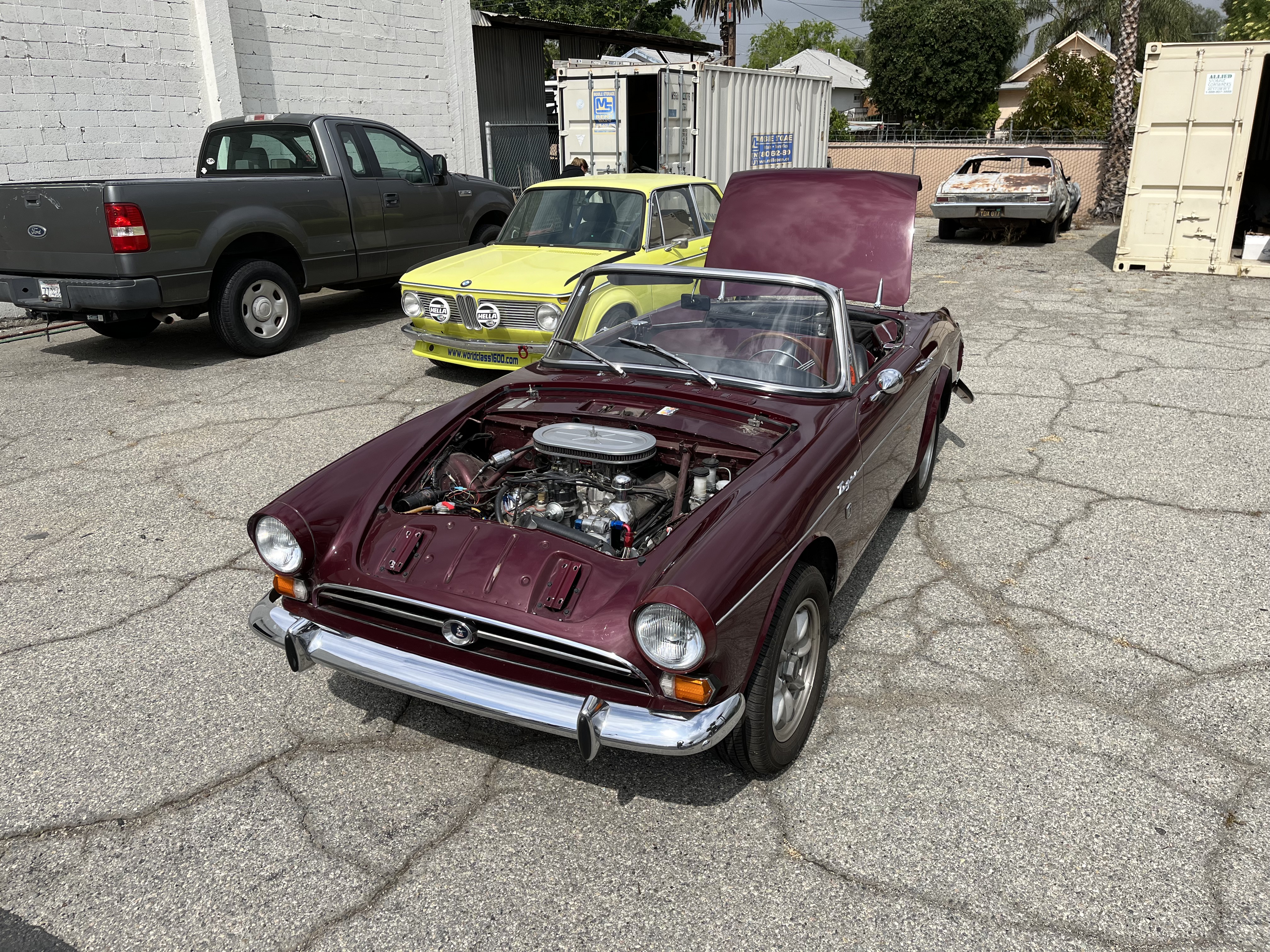

Finally got my Tiger to a bodyshop to repair crash damage done last October. Sadly ghosted by the first shop, wasting 4 months. But it has worked out far better, a true classic car restoration shop…one car at a time. Now to wait for the order from Sunbeam Specialties to hit the doorstep and them to the shop for re-assembly.
By the way, the hood is at home, don’t need and sanding dust on the carbon fiber hood!
Danno66
120
Update time. After looking over the car with body man, I decided to do a full paint job instead of trying to just patch the corner. So, a large order to Sunbeam Specialties for seals and trim pieces. Then I got carried away and also ordered all new rubbers for my hardtop as well. As I write this, car is on frame rack, stripped and being pulled to see where it goes.

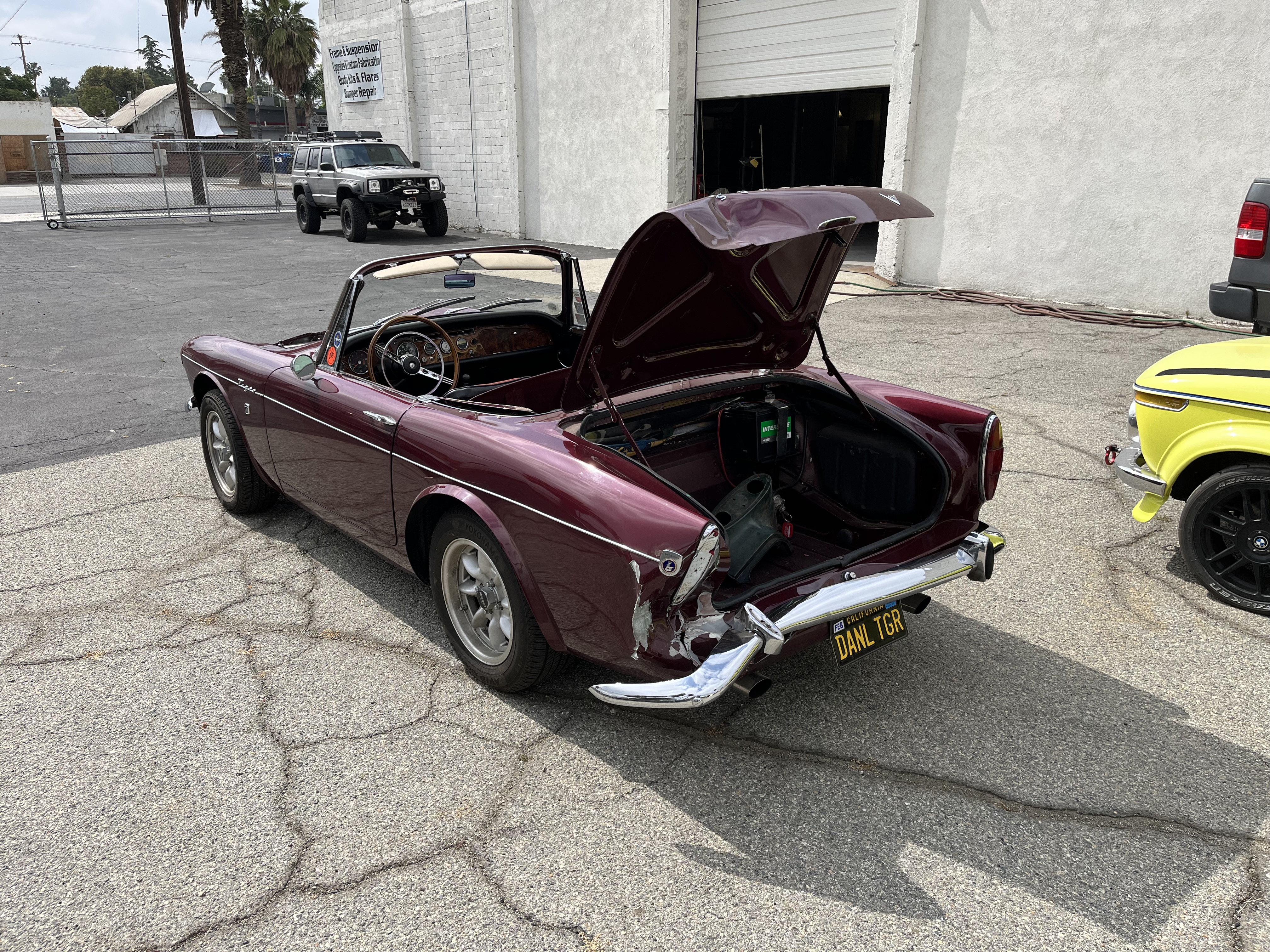

Bodywork update time for the group. I visited today to do the finals test fit of the LAT style hood project. And caught up on the progress. New clip and valance installed, original metal used as much as possible. Good work takes time, I saw one if his other projects going back together, 67 Mustang Fastback, and I have no worries about the quality of the final work.
unbeam
87
Great progress. ls he flanging the original sheetmetal on the rear quarter, then welding the punched holes on the patch, or perhaps using structural adhesive? And maybe butt welding the rear valence, at least the passenger side??
Danno66
120
Sheet metal will be flush welded, there is a backing plate inside for now. No adhesives used. He’s busy hammering out the bumper mount area and trunk lower inner lip. Trunk latch alignment also.
