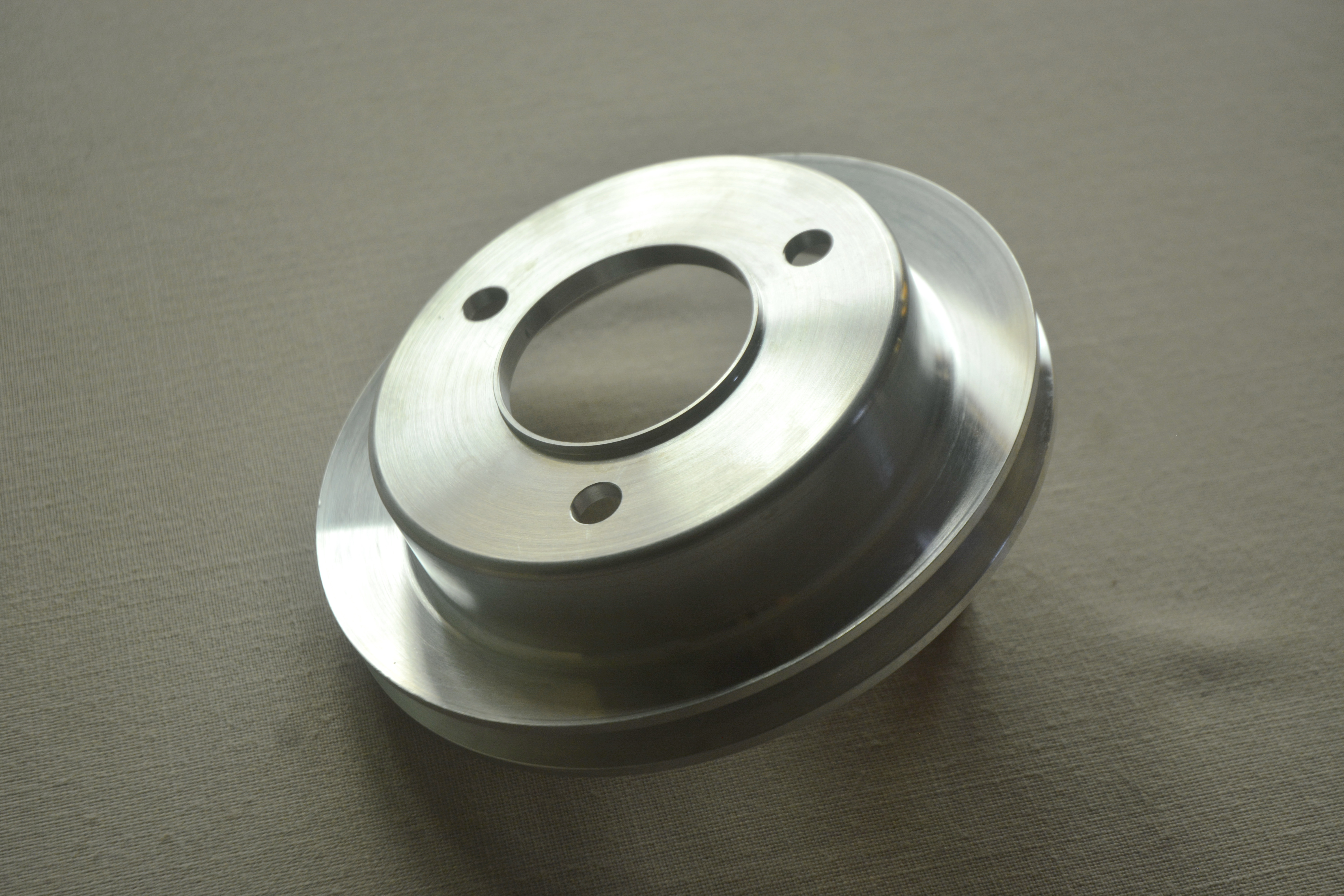

Does anyone have an original Tiger crankshaft pulley they would sell to me? I need one for the Tiger ‘I’m restoring. Thanks for any help locating one.

Good originals are darned $$$$ . I've got a couple here.

Buck- not the damper but the pulley- also had a 289 hp damper re- vulcanized by the Damper doctor in redding-great job
1,398
I didn't have any issue finding a brand new one when I rebuilt the 260 in the current restoration. I just had the machinist order a new one with the rest of the needed parts. I have had prior issues with the outer portion of the damper shifting position due to the degraded rubber....
1,398
They are not special... just a SBF damper. The special thing is the pulley. If you look up the Ford part number C4OZ-6316-A you can see from the part number prefix it isn't special... The 3rd character is "O"... if it were something special it would have been "J" which is the Ford designator for "industrial"... The pulley has a "J" in the prefix....
