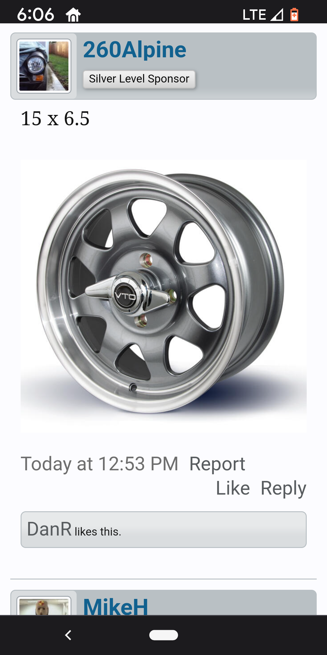

Several suggest the VTO wheels price wise. Then there's the 15 LAT copies that Sunbeam Specialties sells. Nice you're Tigers story .

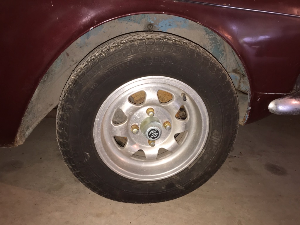

You're absolutely right they're 13" it's been so long since I had it out that I forgot. I'm going to try and post a picture of the wheel.

I have the same wheels. They are Western Dan Gurney wheels. I like them.

As mentioned a little earlier.. Sunbeam specialties offers a 15" verison of this wheel made by VTO for the sunbeams
Of course there are minilite wheels and various similar design from panasport, VTO, BG and JBW. There are 15" Silverstone replicas . and VTO also do a libre 4 spoke for sunbeams

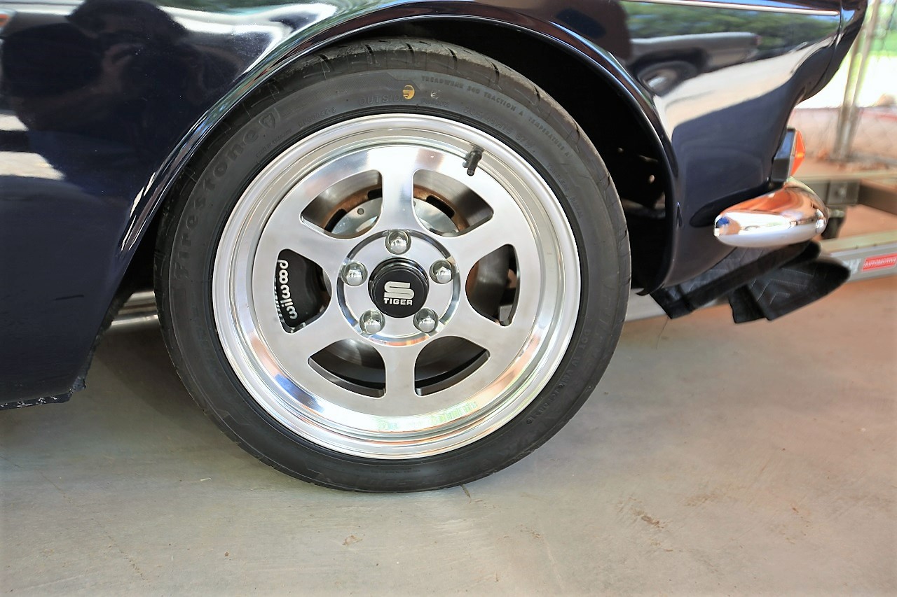

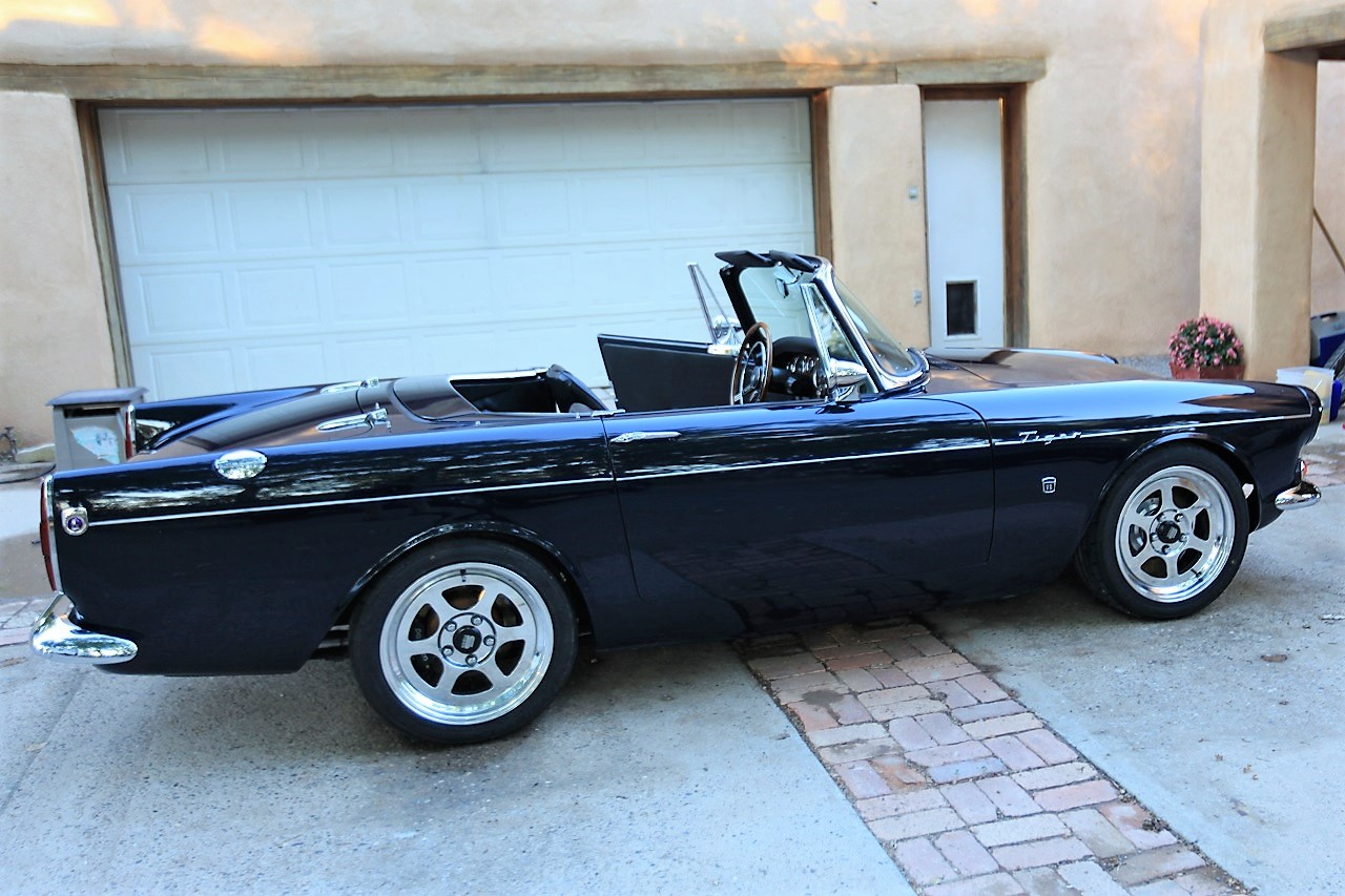

CLIFF_MK1
212
These are my new wheels from Image. They are 16 x 7 but Image will make what ever size you like with stud choice and offset. On my suspension, I needed a 5 inch back space to place the wheels inside the fenders, but another car may need a different offset. I choose the 3 piece Billet 50 style which was originaly made for the UK Ultima Spots Car. I choose Image because my unique suspension needs with a large backspace made it hard to find a production wheel. Centerline did have one model which I initially used but I like the style and appearnce of the Image better. Suspension is a Dale's front and Ford 9" rear. Cliff
