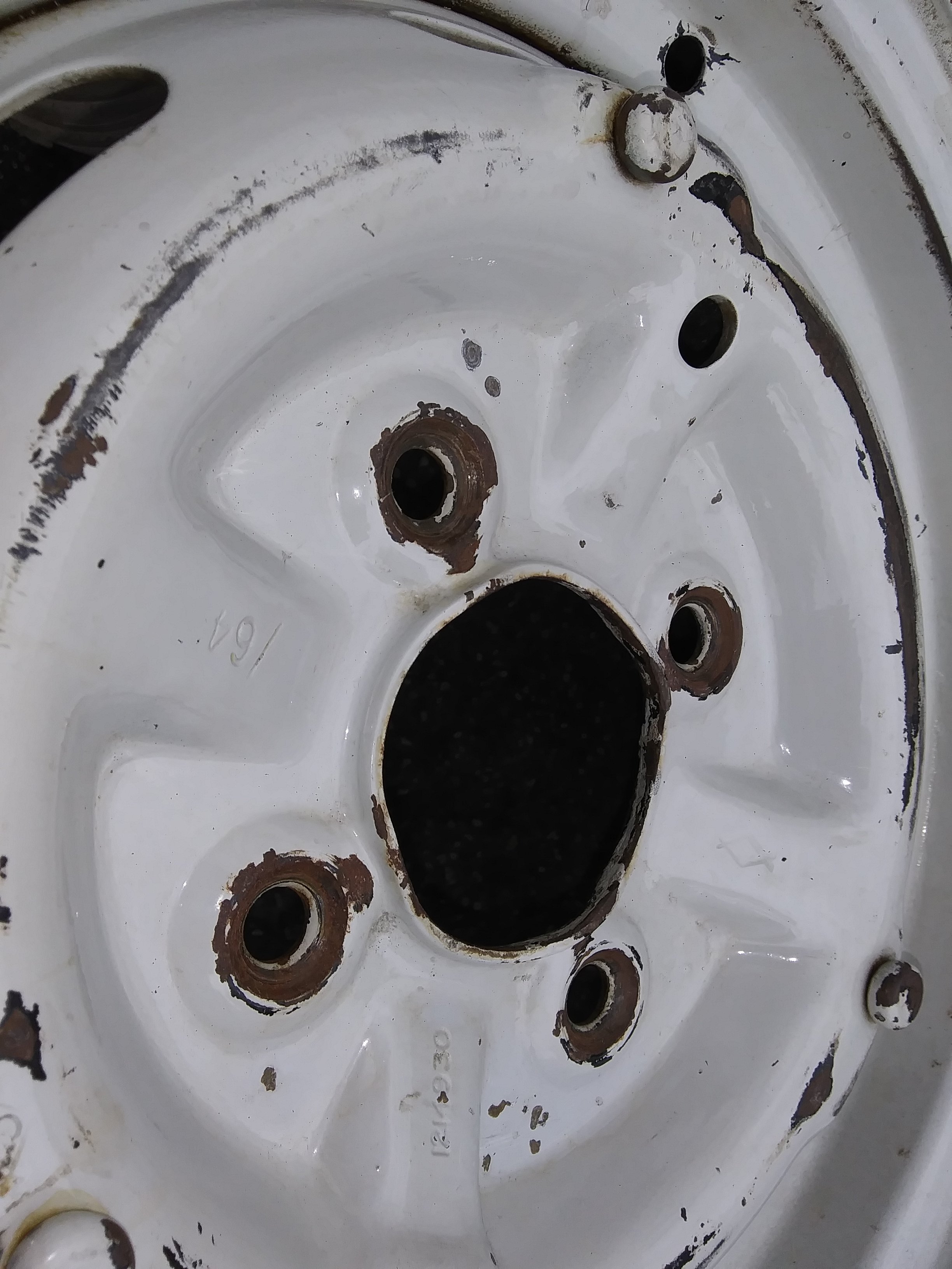

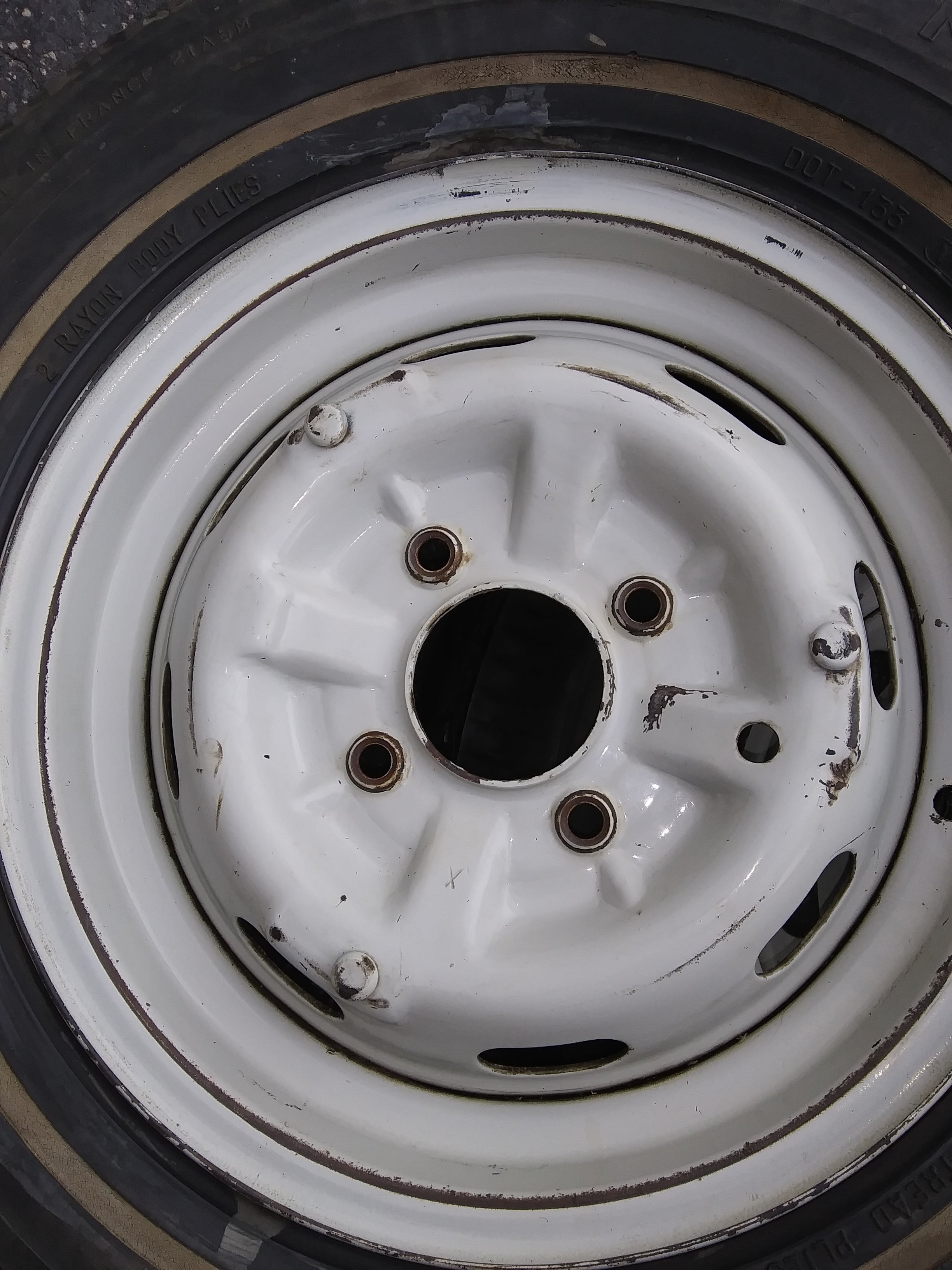

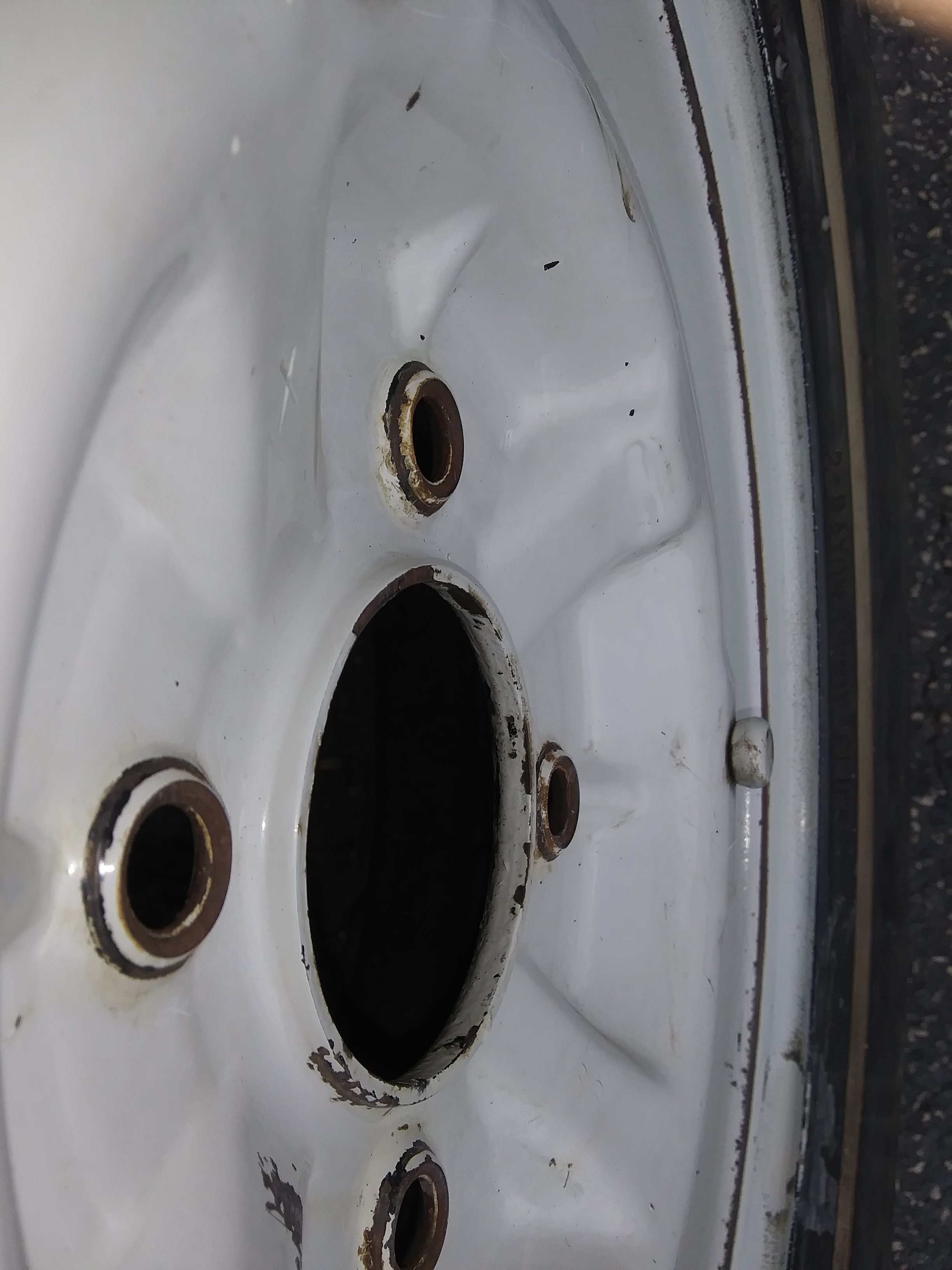

I have a rim dated 64 and one dated 66. On the 64 rim, where the lug nuts seat is recessed into the rim. On the 66 dated rim, where the lug nuts seat is opposite where it stands proud from the area around it.
Does this sound right? And do they use the same lug nut? Are they both Tiger rims?
See pictures attached.

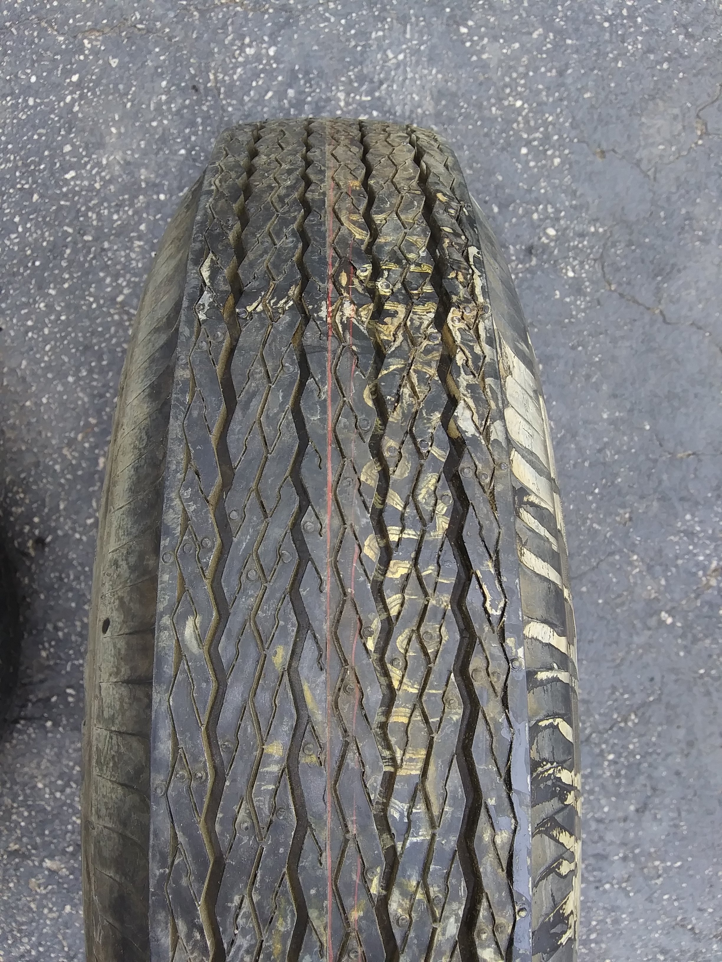

Also, one has a Firestone tire that looks to ne original, never used. Although it is unusable as a tire would it have value to anyone as a spare for show only?

The later rootes wheels have the triangular pressing to strengthen the stud hole which helps prevent cracking and stids pulling through.
All the wheels use the same wheel nuts eith a tapper .
Also make sure the seating area of the wheel stud seat is not painted or the wheel wont seat properly and the stud hole will get ovaled

Thank you. I knew about the triangular pressing, just wasnt sure about the taper for the lug nuts. thanks again,,,and i will make sure the seat is not painted. Mat

The info I posted as far as part numbers is what is listed in the parts manuals that came out of the Rootes dealership in Huntington, W. Va. The manual was printed in January, 1968. There were running changes to many parts probably due to changing vendors. I've seen some Tigers with reinforcement of the lug opening. If there was reason to buy a new wheel after the end of production of series Alpines and Tigers as I did when I hit two trees with the series 4 back in March, 1970 you ended up buying part number 71237218. It didn't have the knob to hold the hub cap. It had a ridge stamped into the wheel. There was another wheel available that was 13" X 5". I've never run across that wheel.
I have a set of four, date codes that are both 65 and 66. I have only and keep the enlarged lug boss ones.
