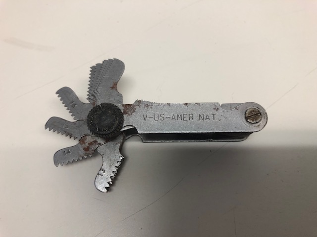

These comp nuts are 1/2 BSSP . The transfer nipple measures 1/2” diam and I suppose you could do the math and count the threads per inch with a good magnifier.

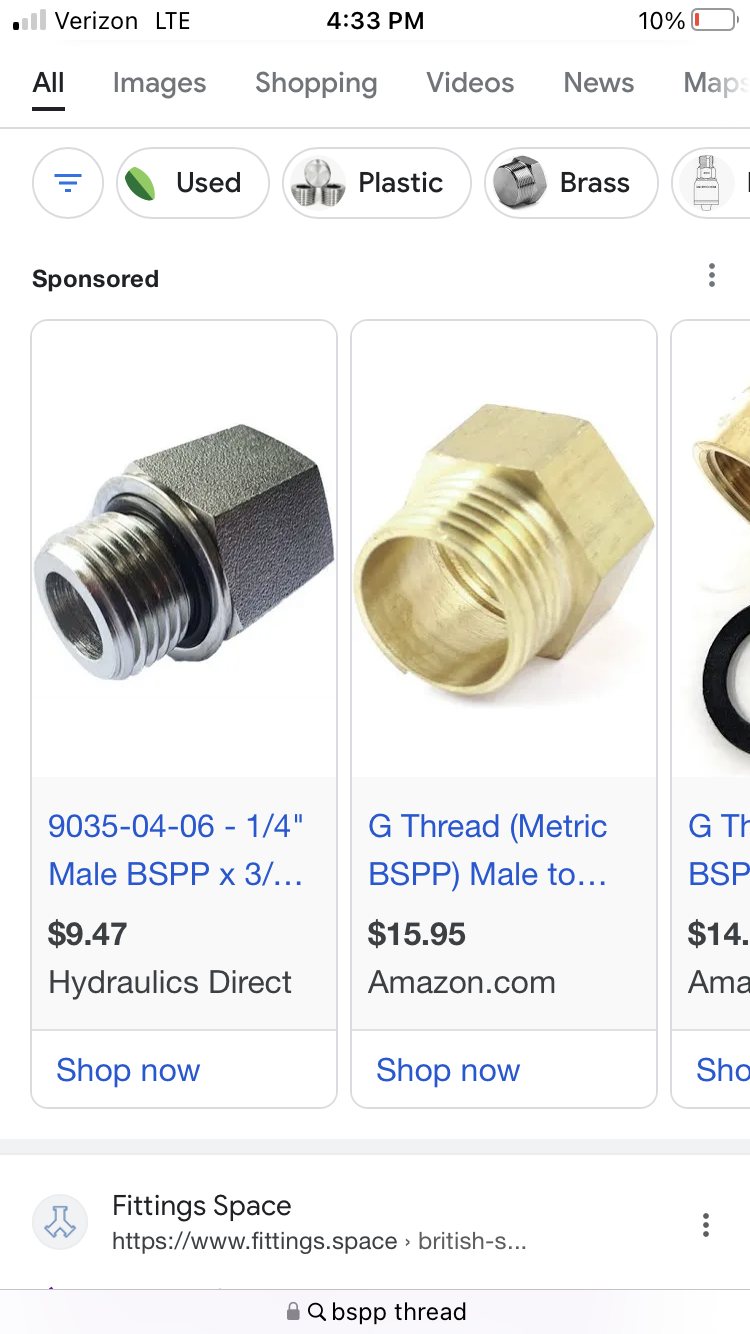

A good place for fittings is hoseandfittings.com. A number of BSPP fittings available. Did not search for the gauge, but it has info how to identify the correct fittings.

BSPP British standard parallel pipe. BPST is a tapered thread and will not work.
Yup. The British do have a different nomenclature than what is used in the US. There is both straight and taper pipe threads used in the US but why the British used the term parallel and the US use straight is beyond my thinking. Do you know if the fittings can be interchanged and. Does the US use 55 degrees or 60 degrees
