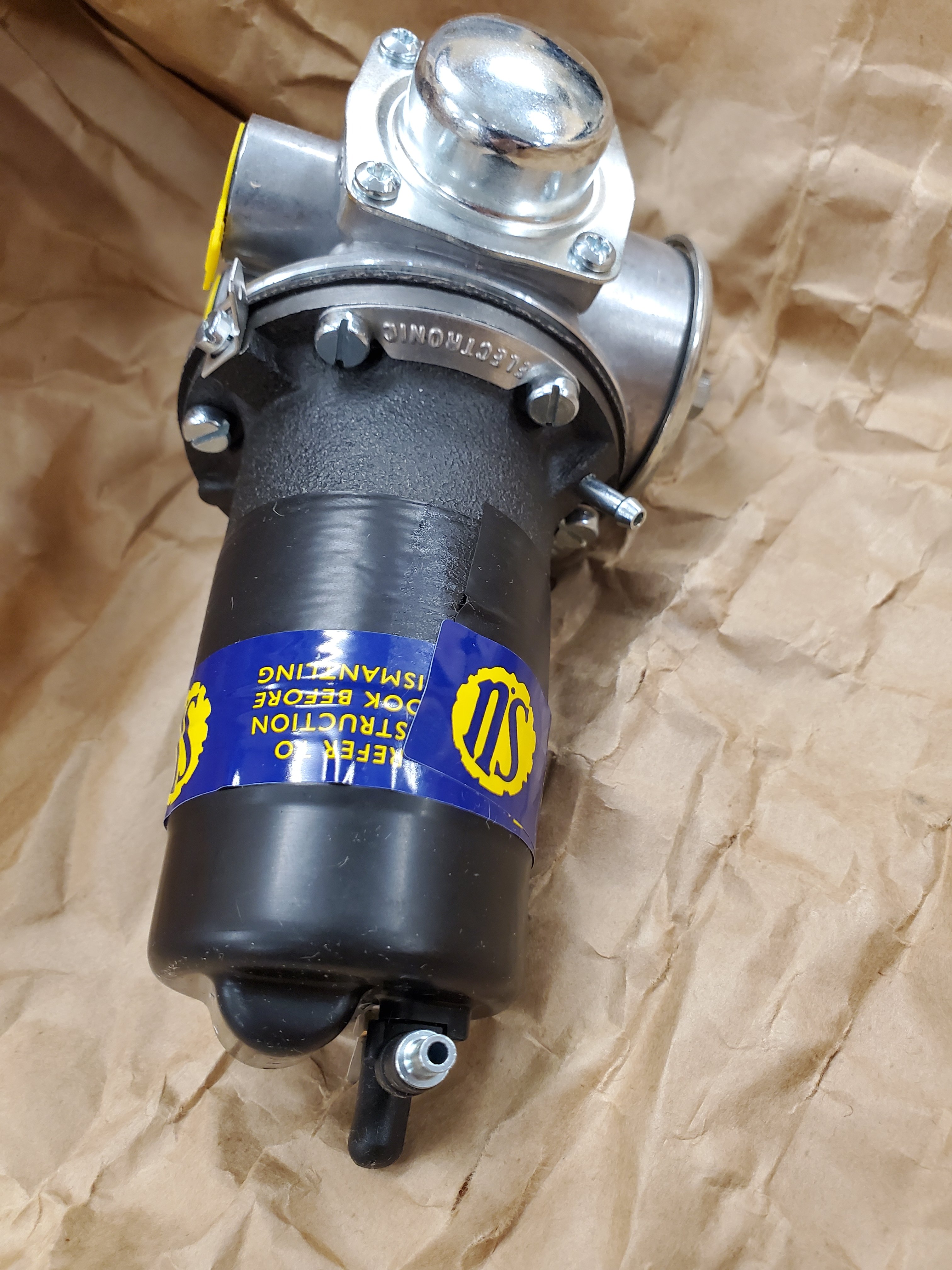

The new SU fuel pump came in today. What are those 2 silver fittings for? Some sort of vent? What are they connected to?

nothing on the top one. the one near the base had a clear tube Like the w/s washer hose) and it gets routed through the hole on the RH side of the bulkhead in the trunk

The top one in the photo or the top one on the pump (asking for a friend):)
