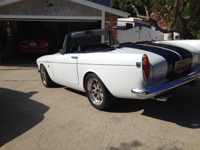

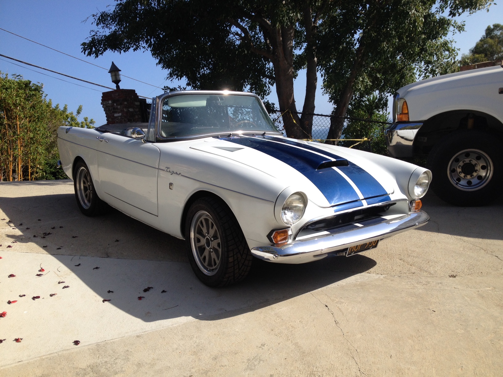

You mean like these? 10 years ago I restored a Tiger for a friend and he put on these wheels. He got PS Engineering to tweek his front wheels to reduce the front track width.

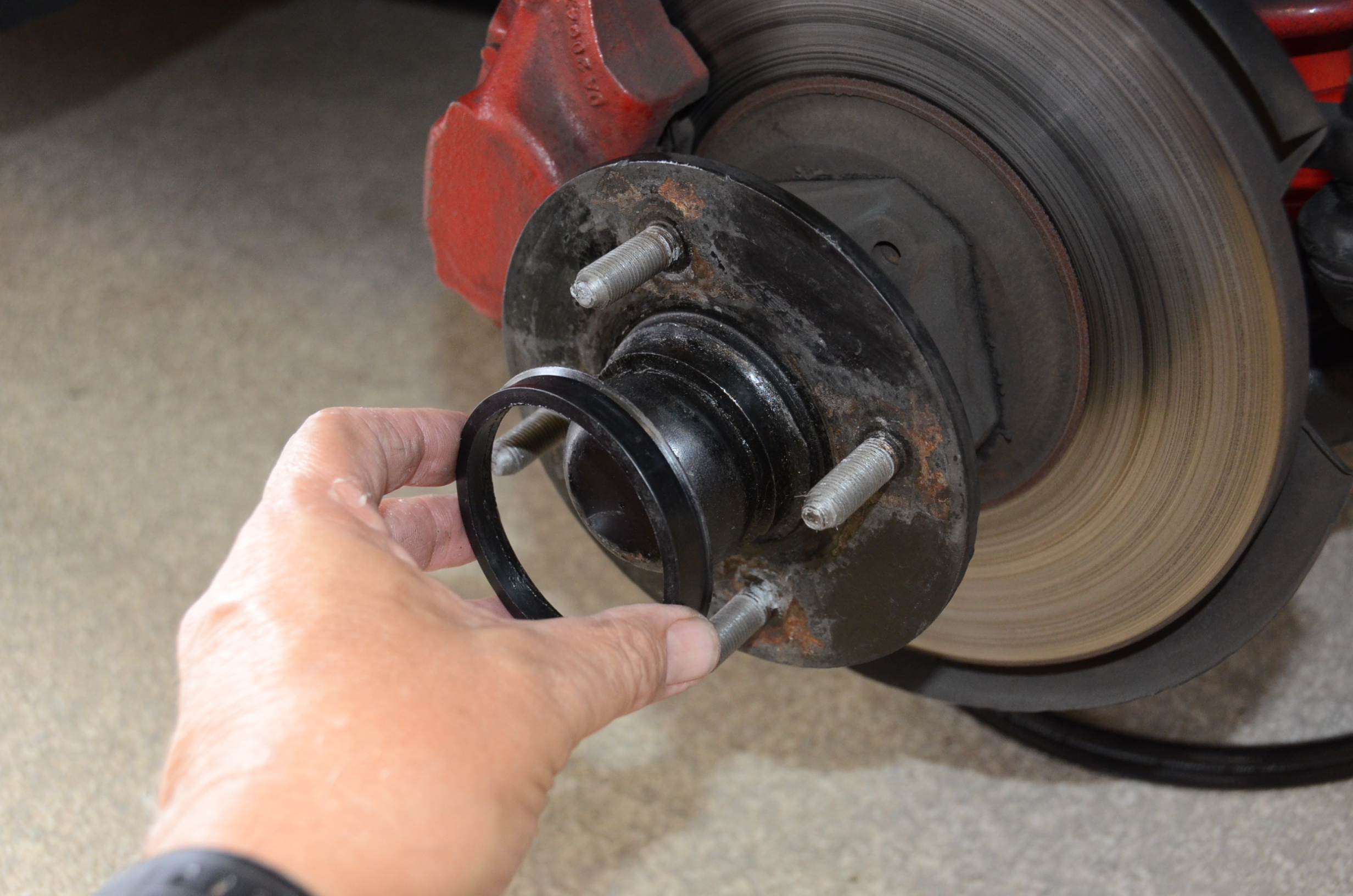

These are really nice. Don't give up. I had a set of x 4-1/2 Ansen slot mags machined to accept 4 x 4-1/4. WHeels are either hub-centric or stud-centric. If the wheels are hub-centric, meaning that the axle hub is a precise fit into the center hole of the wheel, they will be concentric. If there is a mismatch between the O.D. of the TIger hub and the I.D. of the wheel center hole, www.justforwheels.com will make a custom set of adapter rings, for around $30. I found that the rear wheels were not as critical and that the elongated slots aligned the wheel just fine, no vibration. It looks like these wheels use shank type lug nuts which would make this feasible. Stud-centric wheels depend on conical lug nuts to center the wheel between the studs. If these wheels are stud-centric, I think you are out of luck.
1966 TGR
133
adapter ring photo
adapter ring photo attached, I think
