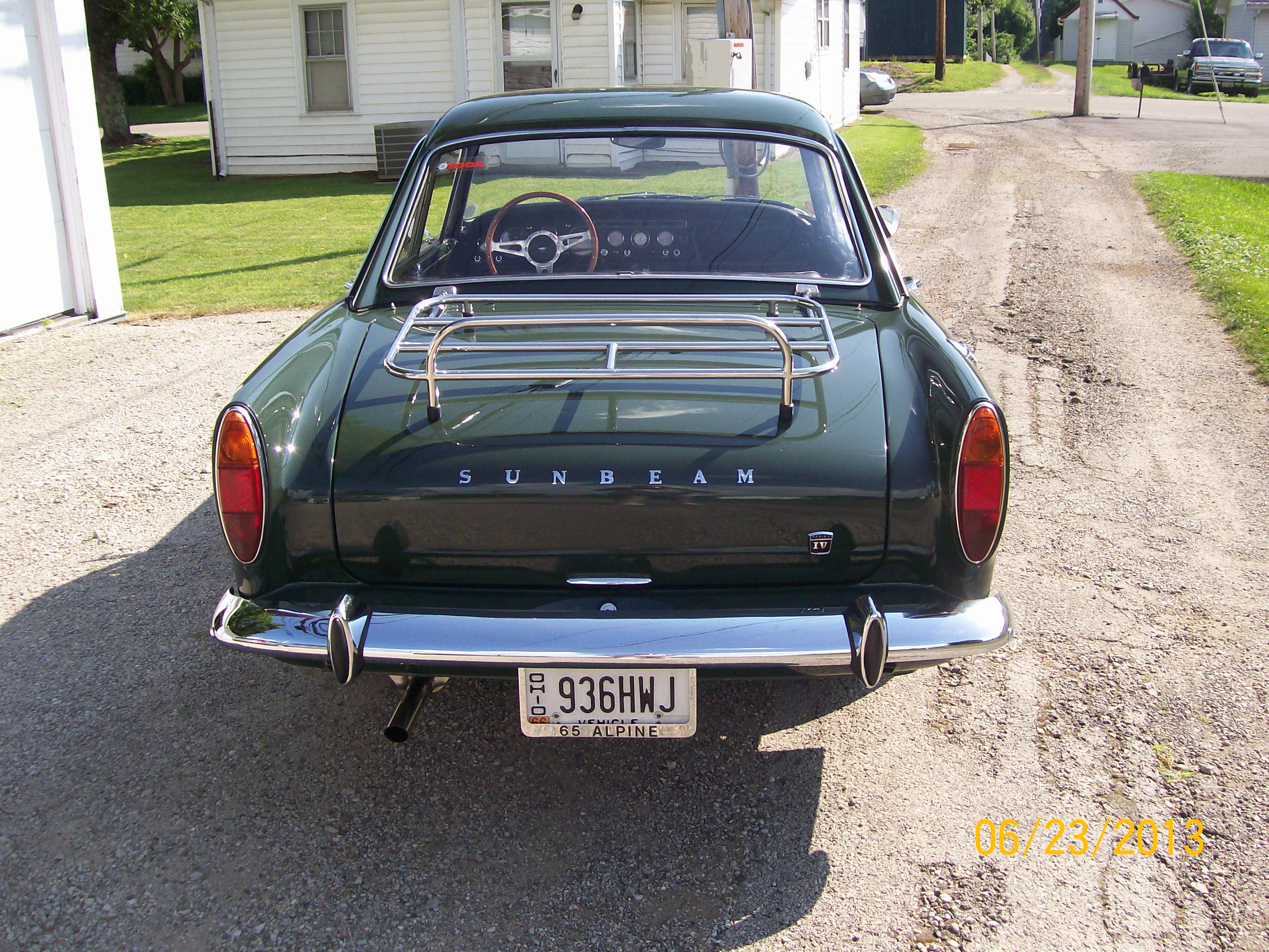

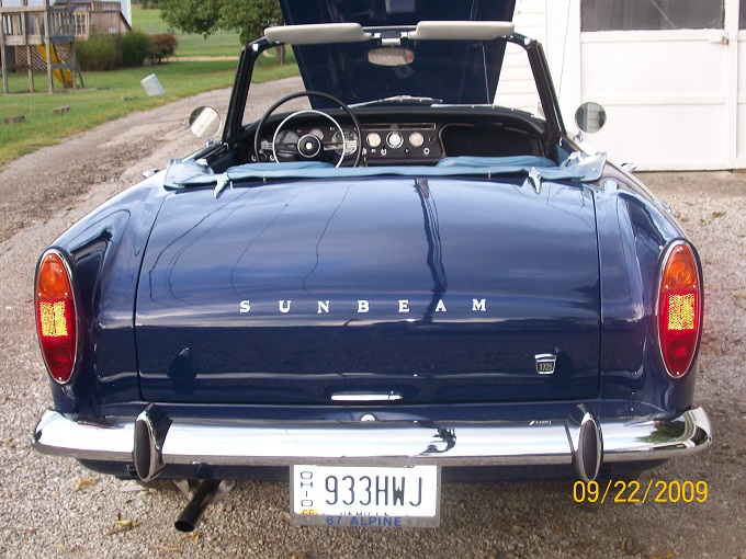

FYI, The green car is inside screw amber lense and the blue car is outside screw amber lense. I still have several sets of both lenses. I also have an NOS set of Wipac reverse lights with amber lense. My parts manual shows them to be a set for use in France.
