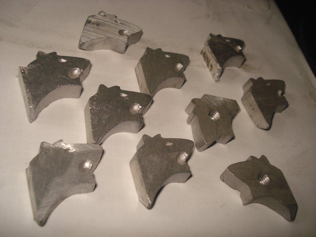

I will have more of these soon-will take some to SUNI!
