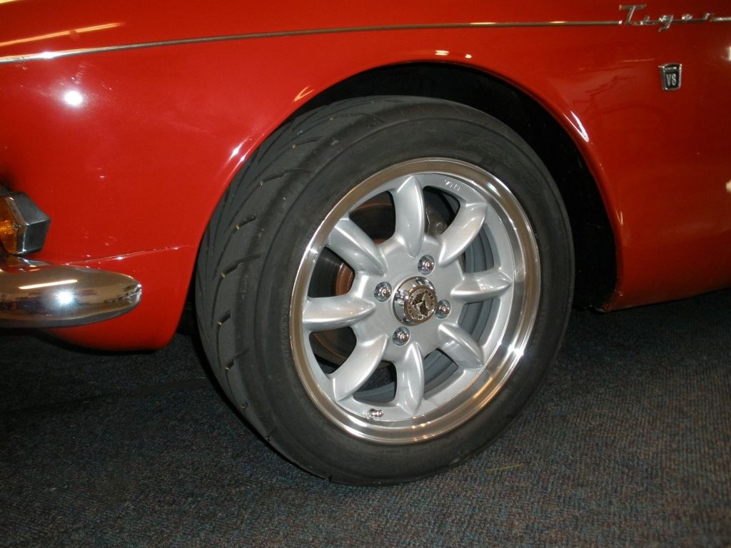

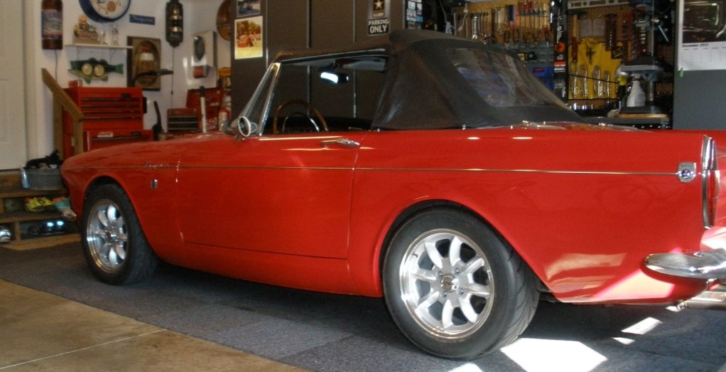

All you spinner haters will rejoice. Have new 15" wheels on the Tiger that have replace the 13" JAP wheels.
Can not fit any more tire in the rear (225/50 R15"). Actually have to roll the right rear fender due to some contact under hard acceleration.
Weather would not cooperate, some crappy pictures of a dirty car, but you get the idea.
New Wilwood front hubs, vented disks and 4 pot calipers on the way.
You can really see those RX7 rear disks now.

Duke,
Looking good.:D
An unsolicited thought about the fender clearance from the peanut gallery. Is the rear clearance the same on both sides? The panhard rod centers the car body over the rear axles. If the clearances are different, maybe an adjustment to the rod would move the body over enough that you would not have to roll the lip on the right side and still have enough clearance on the left.
Also on my car I noticed that there was significant extra metal where the inner fender well was spot welded to the outer fender. Rather than try and roll the lip, I cut back the extra metal with an air powered cutoff tool to close to where the spot welds are. Something like that might be easier to do than rolling the lip.

Those are the exact same diameter as my 245/50 14's ... I'm gonna guess by looking at your first pic that there's a lot of room between the inside of the tire and the leaf spring? It's always a compromise... widen the rear track a bit... or get fender clearance... :rolleyes:
I'll have to check. No panhard rod installed. It would have ripped out is about 5 seconds.
Am thinking it would be easier to just role the lip than move the rear axle. Looking at borrowing the Eastwood tool that bolts to the hub.

Check the tire to spring clearance on both sides they should be equal. With my 16" panasports the offset in the rear is 15mm and the wheel fits in the wheel well...What did you get ??? Also those fender rollers that bolt to the
wheel hub can do some nasty damage to your fender so I would only do that as a last resort....
Also..Now you must lower that front end....mine is about right..

I'll have to check. No panhard rod installed. It would have ripped out is about 5 seconds. .
I thought you have a torque arm to control axle wrap. What would rip it out then?
Also without a panhard rod, watts linkage are something to keep body and axle centered I am thinking the lateral cornering forces trying to separate the body and axle horizontally are being concentrated in your rear spring front mounts. The front mount is famous for cracking in a normal stock setup. I hope you have them reinforced. Good idea to check them for hair line cracks in the dog leg part if you haven't done so recently.
IMHO, getting Tom Hall's panhard rod relocation kit (or equivalent) and mounting the rod as low/close to the axle and parallel to the ground as possible is a much better approach than having none at all.

Tom Hall did a tech tip in the STOA newsletter last year. IT Wasn't recommended. The inside fender lip is double layered and the tool didn't work as intended. Before you try it give Tom a phone call.
Gene
Torque arm does very nicely as I have 0 hop with wheels a spinin. Dale A told me to pull the panhard rod as it is not needed with his rear springs. I have never had any lateral movement tire rub even during autoX with the rear 205 13". The tire is rubbing only during hard acceleration when the rear end squats due to the torque arm. The panhard rips out due to being mounted incorrectly. The axle pulls on the rod and mount instead of compressing it. MKII fixed the issue. My mount on the body is unmolested.
Front spring mounting points have Tom's reinforcing kit installed.
Before welding. Sheet metal screws were removed and holes welded closed.
No wheels hop demo - http://youtu.be/liZy3H7A2Xk
