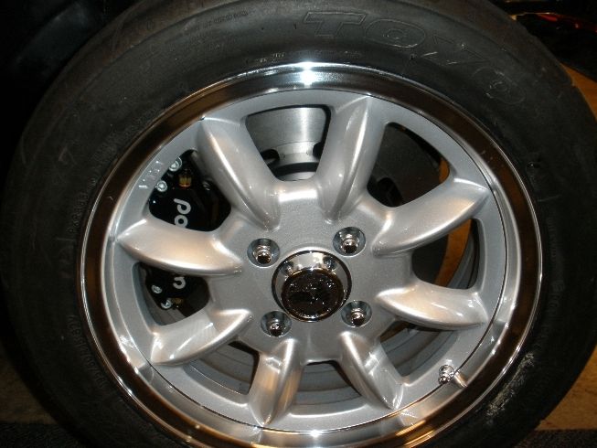

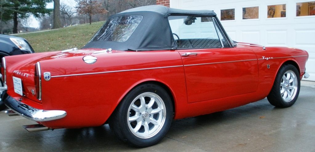

Worked on the rear suspension, everything even. Cut some minor material out. Rub is all but eliminated. Guess it will be gone once the offending rubber is eventually removed.
4,155
Duke,
The car looks really nice.. the wheels suit it and the red/silver looks great. I am very ify on 15" wheels on the tiger.. even variations of the minilite style wheels can make it look quite different, 10 spoke Vs 8, panasport, superlite, minator, Gb, techdel and compomotive... the size of the hub section and shape profile of the spokes makes them look very different... yours look really nice.

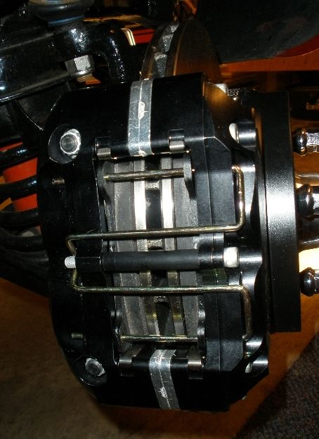

Now...the reason I had to get new wheels.
These combined with the RX7 rear disks and I can finally stop as well as I can go. That is a big relief.
Install will be complete tomorrow and then it's go, stop, go, stop time.

With front rotors like that duke.. your line locker will allow you to shread those nice new rear tyres even longer.. :eek:
also.. are you running wider tyres on the rear but the same profil % as the front.. looks like you might have 55 or 50 profile on the front.. and similar profile.. but wider rubber.. hence a taller sidewall at the rear... whats the overall rolling radius on the rear now, have you effectively upped the gearing?
Duke Mk1a
1,673
50 - front and back.
The RA1 over all diameter was was 22.7", these R888 are 23.7" I have dropped my 75 mph rpm by 100 rpm. Thats what the calculator tells me anyway.

Makes sense, looked like same aspect ratio but different width hence taller profile.. you still running the 3.07? assume whe you go 5 speed the project will be mostly done.. as if!
