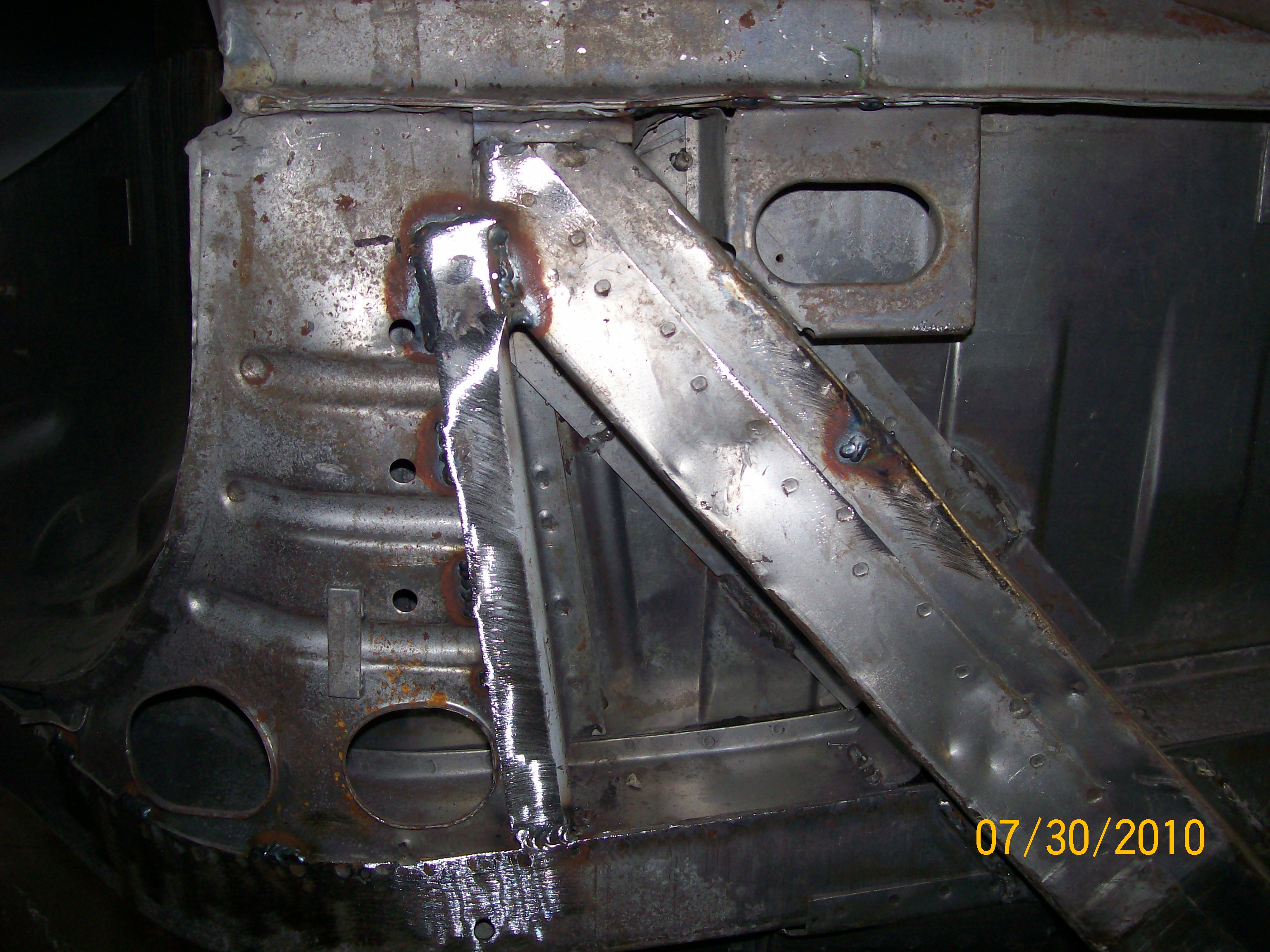

With all of the seam sealer crap removed it's a straight shot, front to rear. In any event, original rockers and fenders have drain holes. The only thing I had an issue with was the strut rods from the top hats to the firewall. I had to drill a hole (5/16) in each end to get them properly neutralized and washed out. The place I took my car had three vats with different solutions and they'd submerge the car completely in all of them. They were also each electrically charged.

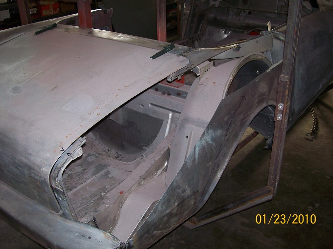

Doug also removed this section of the rear fender wells area in order to clean and treat the area. As you can see he makes a panel to replace it. There's lots of junk / rust if the car is from the middle of the country.
What about drilling holes big enough for access, then plugging the holes with rubber plugs? This would allow room to use a vacuum or compressed air, and then coat the inside with POR 15 or the equivalent. You would not lose any significant structural rigidity if done judiciously.

I agree. That's a good idea. However, it adds time to the job, just like everything else mentioned in this discussion.
Unfortunately, there does not seem to be a perfect solution to stripping the paint and undercoating from a car.

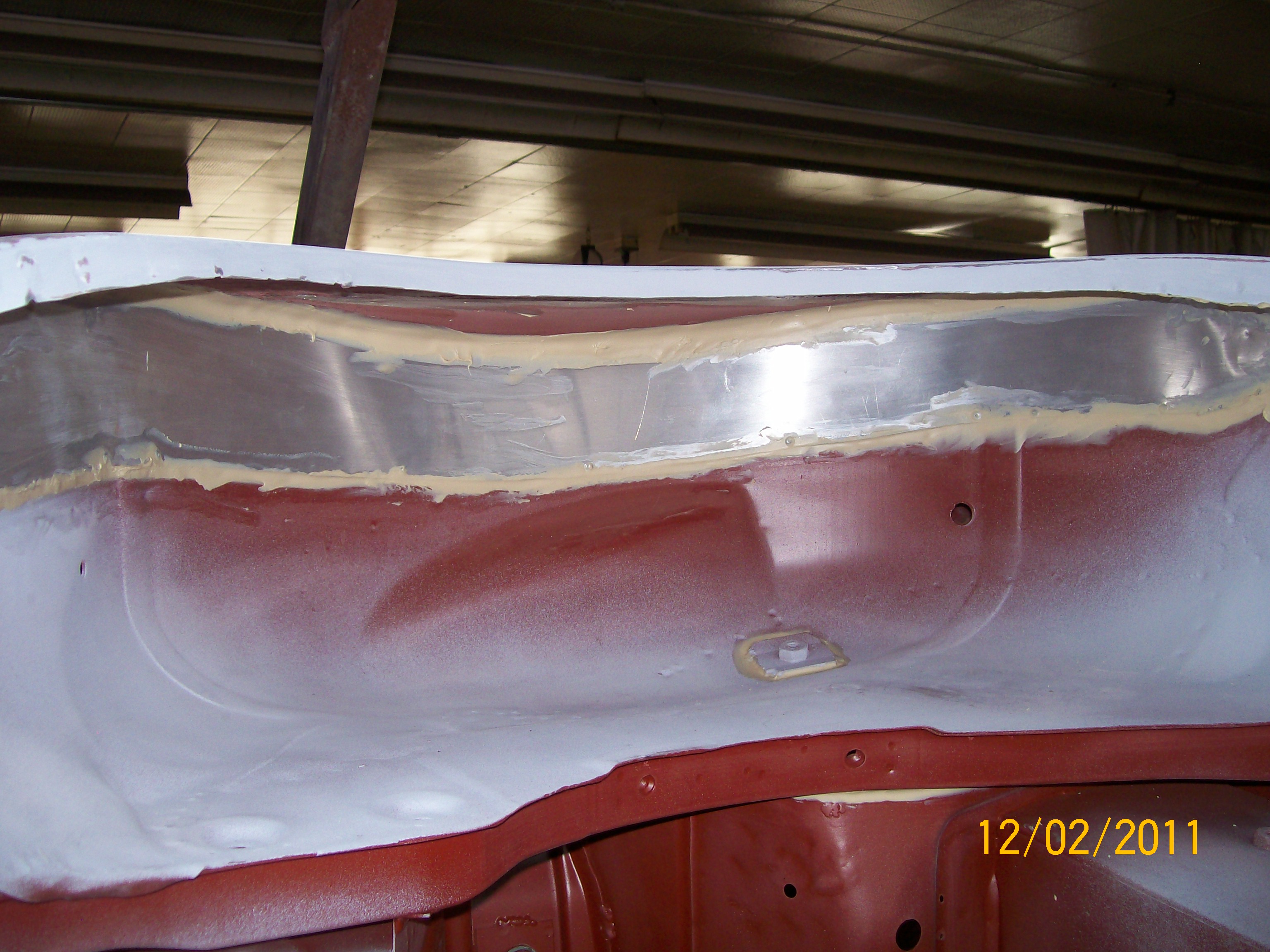

This photo shows the new panels that replaced the ones that were removed.

If you're going to this extreme on one of my wife's cars, why not open up the area? This shop started working on Sunbeams back in the 60's so he does what he feels is best for down the road. Doug also installs extra bracing for using jack stands behind the front wheels.
But Doug is retired, unless you are referring to another restorer. This discussion started with the difficulty of getting a car dipped, costs/delays/distance and how hard it is to get dipping substances out of the many crevices on the car. Was looking for alternatives that might be more approachable/quicker/cheaper. Of course dipping cleans up all of the nooks and crannies, but is this a case of the perfect being the enemy of the good?
