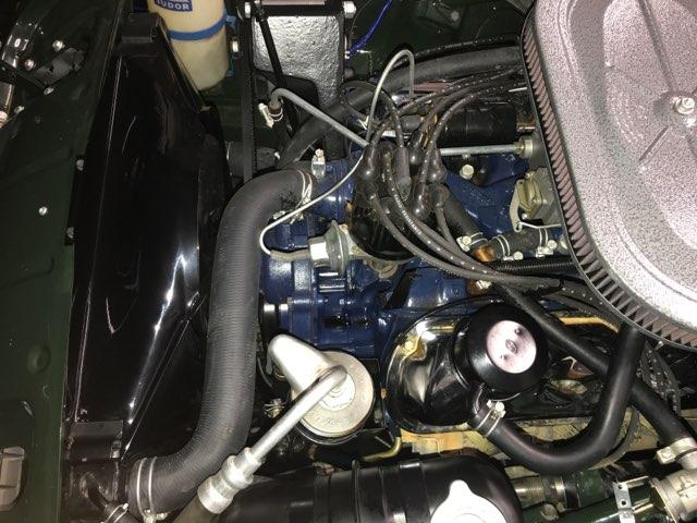

Is there a good source in a rattle can for old Ford blue Look how nice and dark this one is in the picture.
Also how about the tube and the vacuum canister on this distributor in the picture which I understand isn't the correct one. Looked and looked online to no avail.
SunbeamTgr
52
The Vacuum Advance has been replaced with a nipple style, eliminating the female fitting and using a vacuum hose connector. The metal tube seems to be original with the end removed to accommodate the vacuum hose.

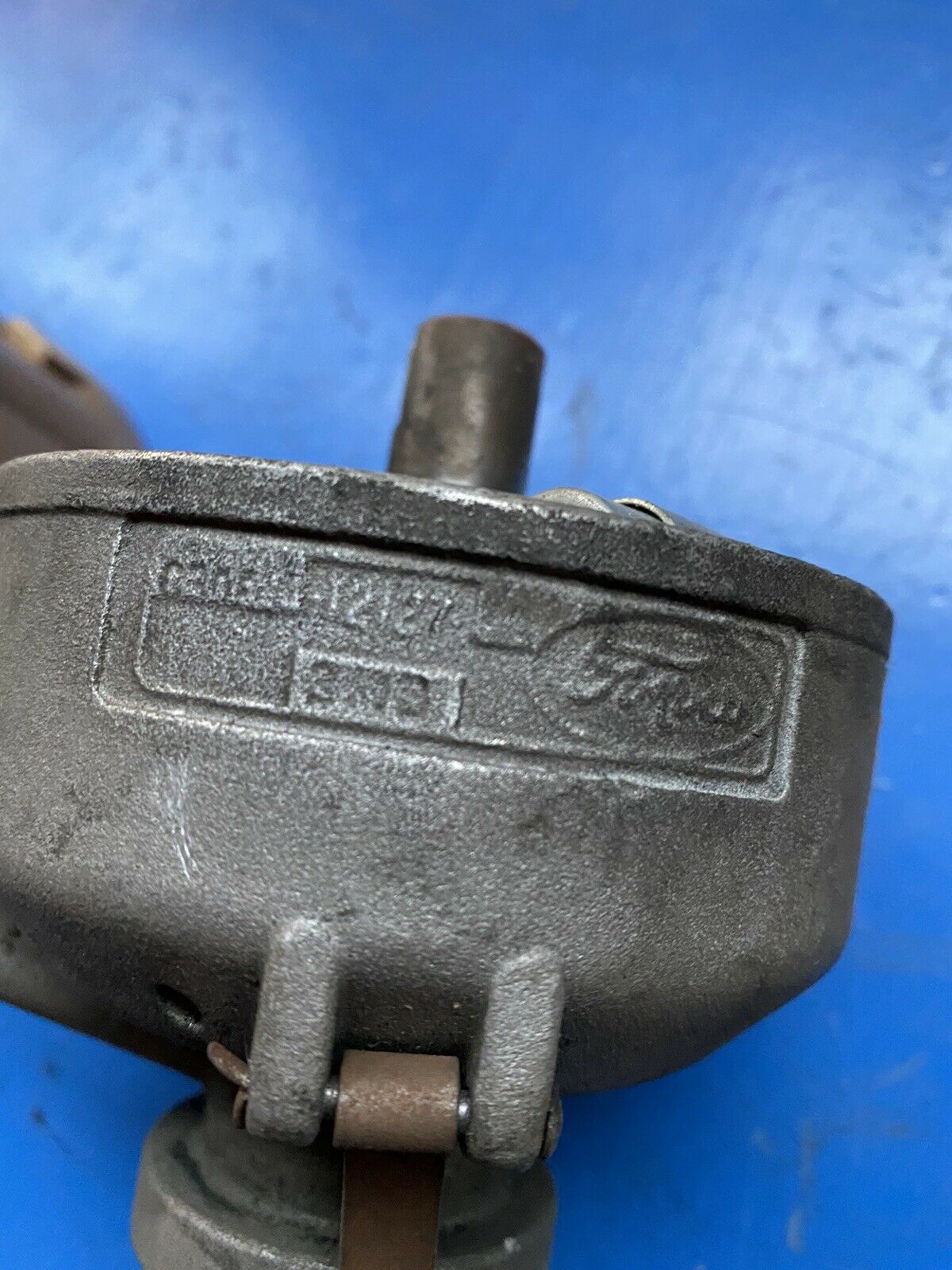

Thanks Gary, got any source for the early style vaccum advance? Here's what came on the car.
Great website hope it can put a dent in eBay's business..
That is the NLA model that's correct for the later cars. Likely I will have the Shelby branded distributor shown in the earlier picture reconditioned and convert to Pertronix. I had a full centrifugal in my first Tiger and it was the VW 009 of choice in my sleeping air cooled car.
Had a conversation with my techie motor types and 2 say don't think a full centrifugal is good on a street car. Then there's the MK2 owner of 30 something years who says they are great.
That's the same one I have that got BAD written across as I had handed several to Dan W. for testing. Like to hear other proponents of the full centrifugal on a stock motor.

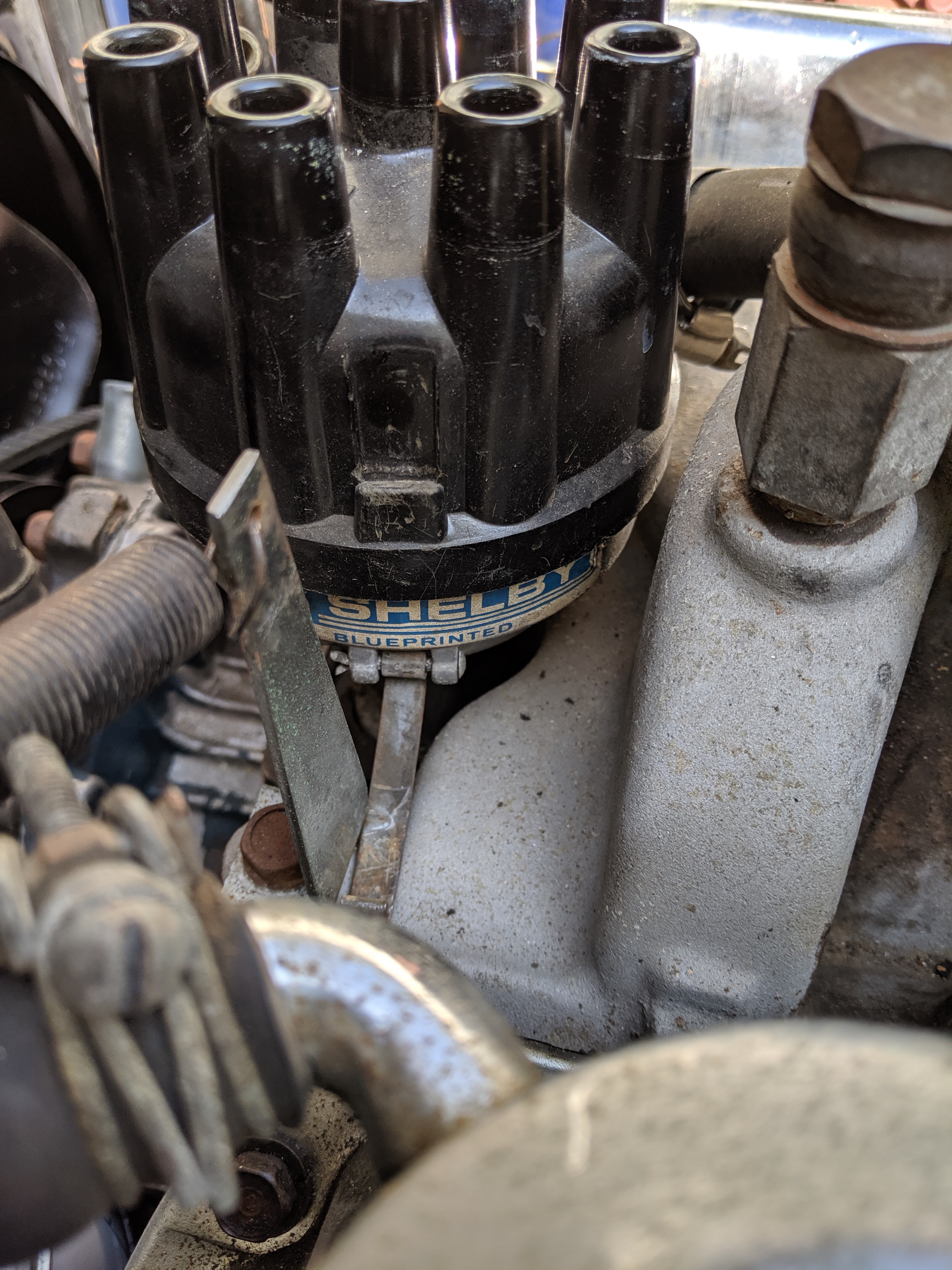

Here's another snap of mine. I was hoping for a picture of the DP distributor. As the Mustangtek page says there's a few of them.
This one's got 96,000 ish miles on it. According to the original owner of the MK2 it was modded right away. It may have been retro modded back to a std cam set up as owner no.2 used the car for commuting per conversation.
If anyone is interested I can have my printer buddy fab up the sticker seen on the picture.

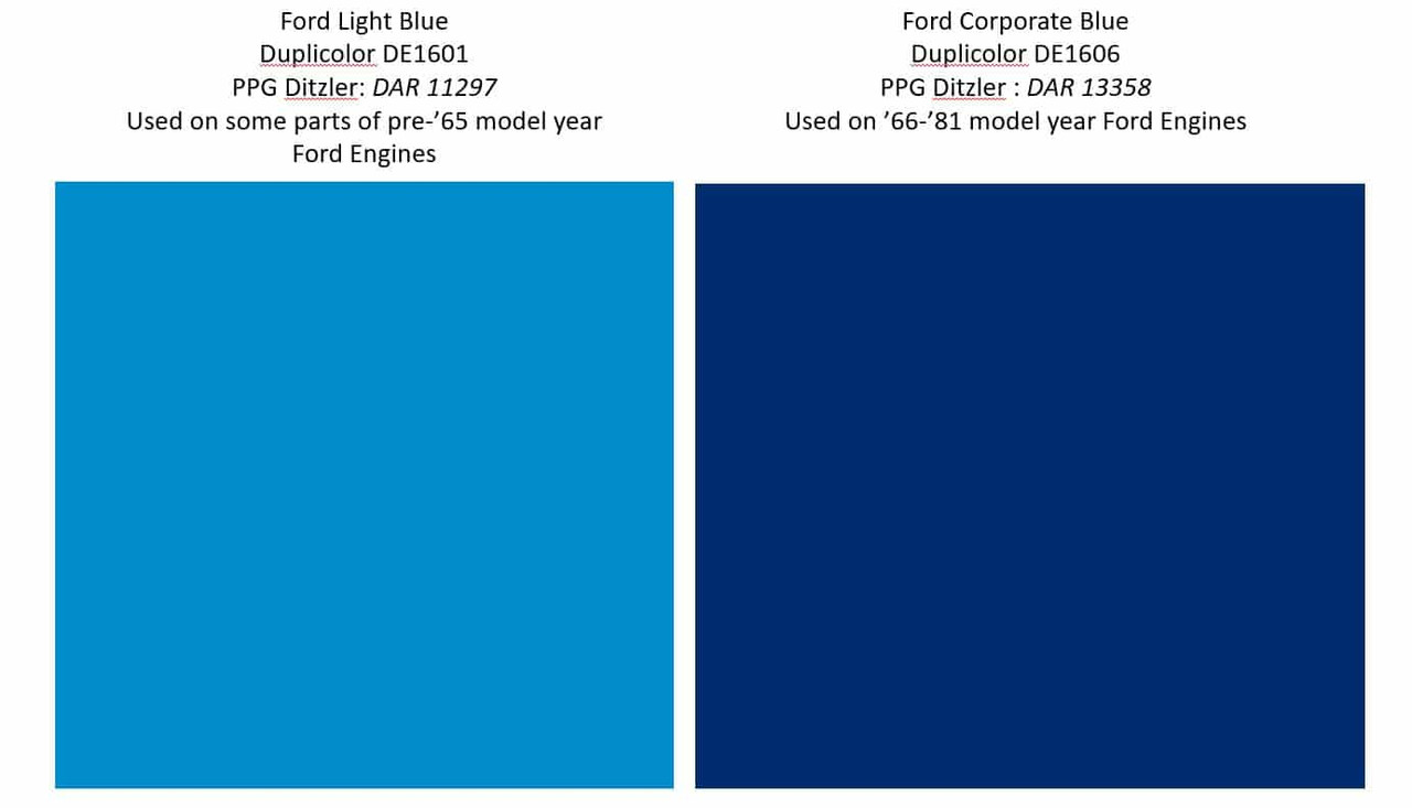

Great was unsure other than early cars black then later cars in blue. The oil pan looks to have been off the car and is old Ford blue.
The rest of the remaining paint is Corporate Blue.

Depending on the source you read and there are many, for Ford engine colours there is a Light Ford Blue or Bright Blue as it’s sometimes called- up to 1965 for some Fords, Ford Corporate Blue 1966-67 and Ford Dark Blue 1968-81 and another engine paint called Old Ford Blue (not sure where this fits in) If memory serves me correct years ago I had heard that Ford Corporate blue was a period correct engine paint, or not the light blue or dark blue but the medium shade if that makes sense. Anybody have any input here?
The motor was a the dark corporate blue, although I did not get the original water pump with the car. The first picture is a recent Dale's Restorations MK2.
The cast iron pump survived close to the Pacific ocean for a couple years inside the garage but I had to put something on it to get it back together. I have some left about the timing cover but the oil pan was resprayed probably when it had a cam change back to a stock spec. Second owner is fuzzy on his old car sold in 1977.

Warren,
I would be interested in getting that shelby distributor sticker
