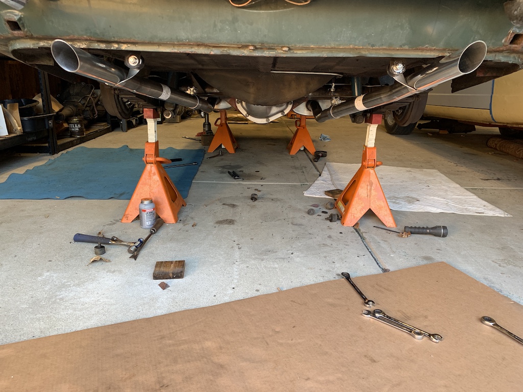

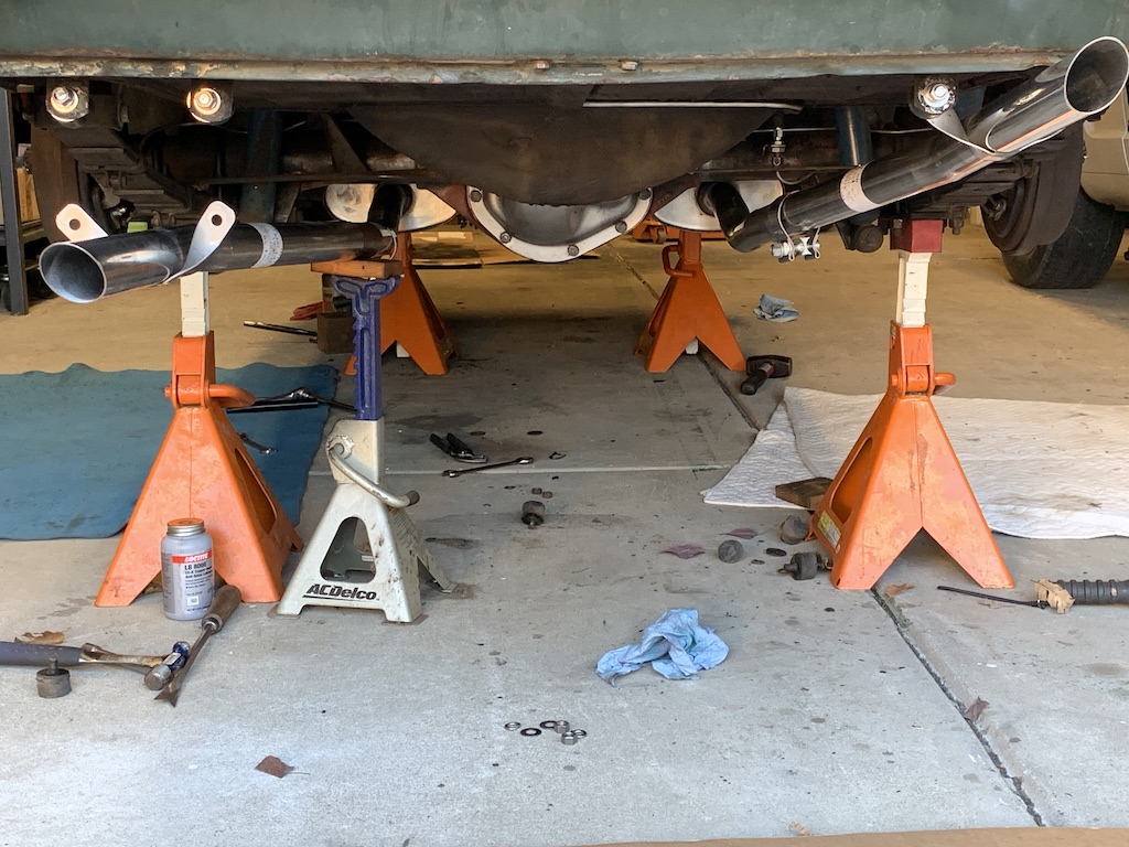

Got the SS exhaust system hung. Overall good fit except for the left tailpipe. Clearance through the frame is good, may need a little 'adjusting' later. Both of those sections fit either right or left side, but one fits better than the other. Would be nice if those were labeled.
Seems like the bend below the axle on the left isn't bent quite enough. After aligning everything back to the mufflers, setting the mufflers at the same level and angle, and same distance beneath axle, the left tailpipe wants to naturally hang about 3 inches too low. When bolted up to the rear mount, it pulls the left muffler up and about an inch less distance below the axle than the right side. It bolts up, just the alignment isn't right. Once running I'll let a muffler shop remove tailpipe and adjust. The right side fits perfect.

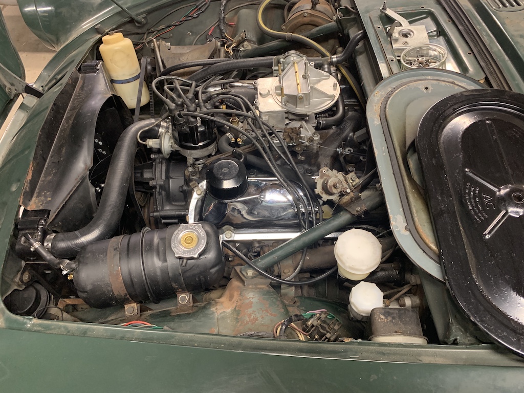

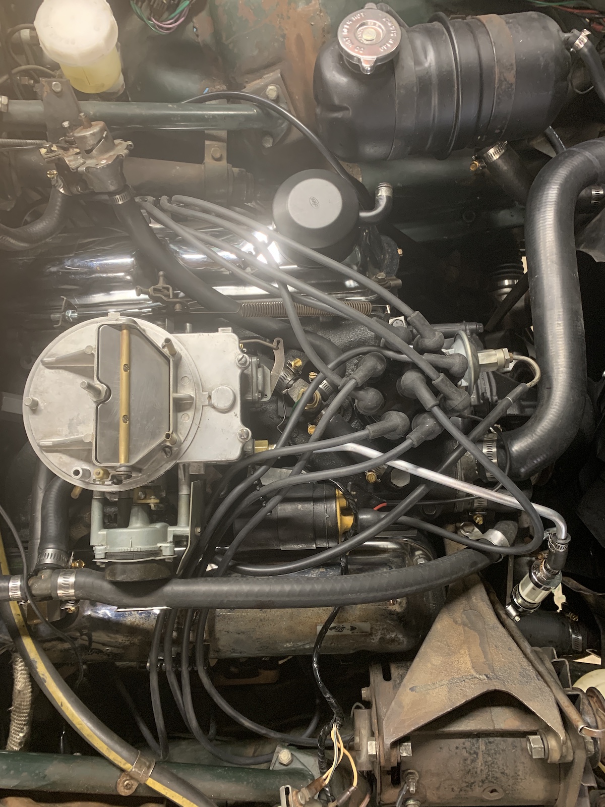

But not getting it to run longer that 5/10 seconds has me frustrated. New SU fuel pump runs at 4 psi and a gallon in 8 minutes. I put glass fuel filter on temporarily so I can see if fuel line crap is getting there (looks clean). I've had the Autolite apart several times to check, all passages blown out and carb cleaner via nozzle shows no obstructions. Emulsifier tubes look good. Accelerator pump works, fuel bowl is at the right level when carb top is removed, tried manually opening choke. Really, there's not much to those 2100's that can be wrong. Engine runs long enough to get the timing close with timing light. At first ran the old points, etc. Changed that out for the Pertronixs unit, changed plug wires, cap, rotor, same result. Tried 12 volts from fuse box to red wire of Pertronix.
Stumped....Need to think about this for awhile. I know, put a 4 barrel on it, right?

Went and got a 1.5 ohm Flame Thrower coil, ran the same. The longest I've had the engine running is about 10 seconds. Ignition switch checks out fine.
Took the carb apart again. Now soaking the Venturi overnight and try again tomorrow.
Taking the rebuilt carb back, didn't try it, it gives me bad vibes. I've never had any luck with rebuilt carbs.

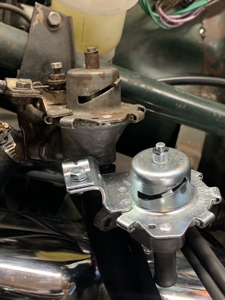

So, I'm searching the web for a heater control valve, and come across this Alpine version on ePay:
https://www.ebay.com/itm/Sunbeam-Alpine-Heater-Control-Valve-NEW-IMPROVED-/360373981373
Ad says it will not work with Tiger, but it sure looks the same. I figure for 24 bucks I'd take a closer look at it. It sure looks the same, input hose fitting the same size, looks like outlet flange will bolt up.
What's the difference between the Alpine and Tiger heater control valves? Something internal?

There are a couple versions out there that push OPEN and pull CLOSED. Or is it upside backwards ?
Rivet
I've removed the rivet and cleaned them out. My old motorcycle pals said they used oil of Wintergreen to rejuvenate old rubber and seals. On my old sailboat soaking the rubber seals in Joy dish soap also lubricated the seals . The early valve worked better for me than the "new and improved," late version. I don't think there is any different between the Alpine and Tiger ones. A British shop owner acquaintance of mine had several he took out of attic storage but apparently they didn't like the heat, but they looked great ;)
